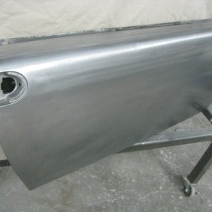

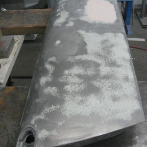

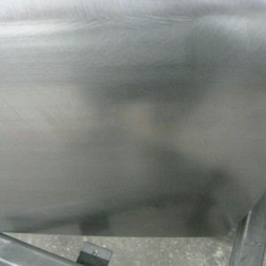

Metal finishing right hand door
(IMG:http://www.914world.com/bbs2/uploads_offsite/www.themetalsurgeon.com-14902-1347326587.1.jpg)
(IMG:http://www.914world.com/bbs2/uploads_offsite/www.themetalsurgeon.com-14902-1347326587.2.jpg)
(IMG:http://www.914world.com/bbs2/uploads_offsite/www.themetalsurgeon.com-14902-1347326587.3.jpg)

bulitt   Wow. Are you lead-ing over the welds? So how many...   Sep 10 2012, 03:57 AM
The Metal Surgeon   No lead over the welds ,just bare metal. I...   Sep 10 2012, 08:51 AM

The Metal Surgeon   Are you lead-ing over the welds? So how many hours...   Sep 10 2012, 01:42 PM

westtexass2k   Amazing work. What are you using to file down the...   Sep 23 2012, 04:19 PM
The Metal Surgeon   Amazing work. What are you using to file down th...   Oct 21 2012, 10:55 PM
