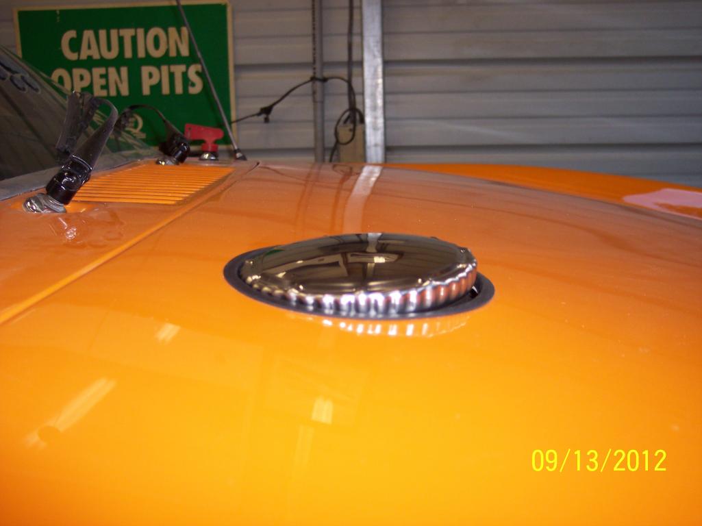

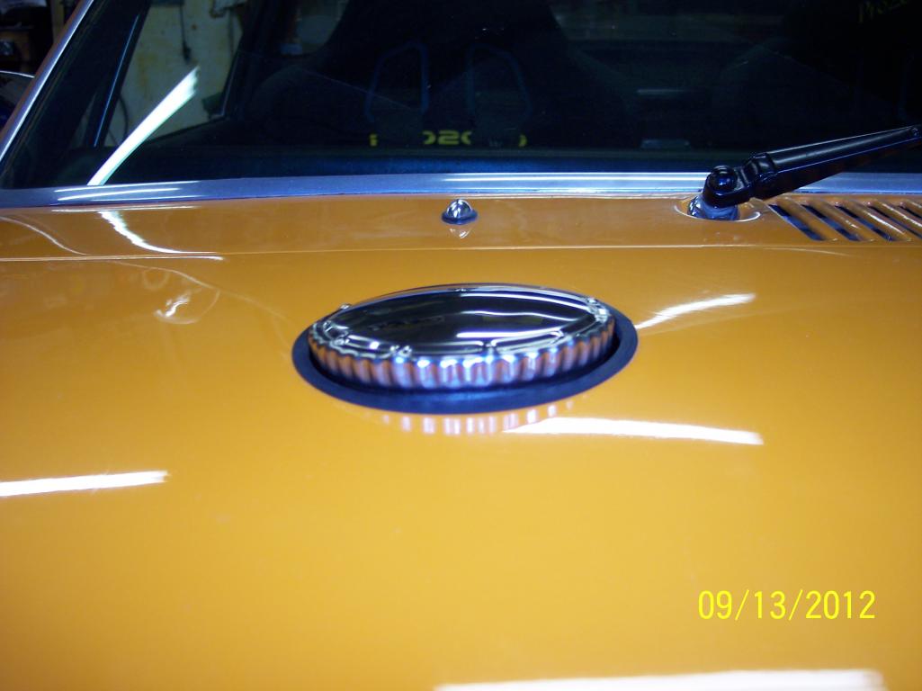

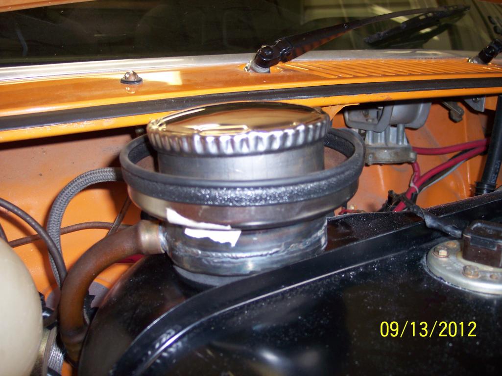

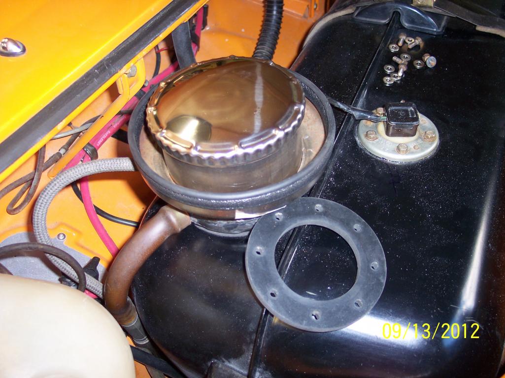

I've gotten the fuel filler tube fully welded up, and fitting the way it will forever. The drain hose and vent hose are set and functional.
Last up is setting the height of the rain water catch ray. I'll do that over the weekend, and cleanup the welds. Next week, the filler will go off to the powder coater for a shot of semi-gloss black to finish.
I had my local gasket company whittle me up a 1/4'' thick neoprene gasket that raises the whole unit up a little more for what I fell is a nice height. With the varying gasket thicknesses I can adjust the total height to what ever I wish.
Now if I could only get my quote back to finish he bat handle (IMG:style_emoticons/default/dry.gif) I'd fell a lot better.
