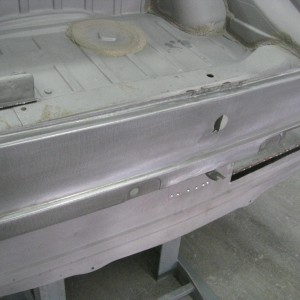

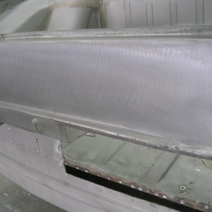

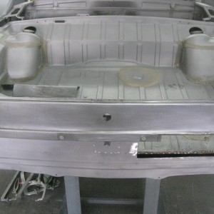

Hi, i'm currently converting this 914 to a GT for a customer and thought i'd post the metal work progress as i go along.
Thanks for looking !

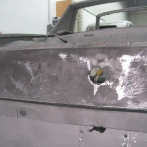

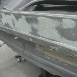

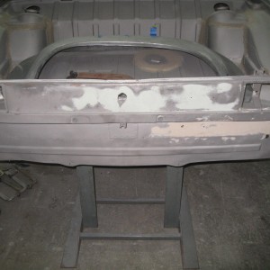

The rear show evidence of being lightly hit.Rear inner brackets had to be relieved to gain access to straighten out the drip rail flange.Once straightened the lower section was removed as been previously badly repaired,and upper section pushed up,where rule displays a non straight line.Also this will make ease on replacing rear trunk floor inner right corner panel.
Last photos show the rear panel being filed up and metal finished.
