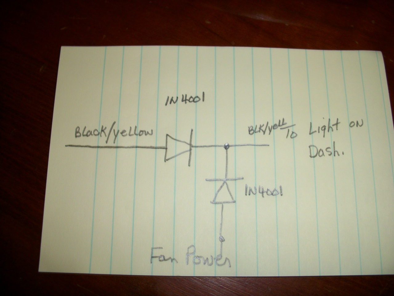

> Powering a light with two different sources of 12 Volt power, one doesn't affect the other

Possible by using two steering diodes. I believe 1N4001 diodes will support 1 amp. Should be more than enough for a small indicator lamp.
Jim, one power from relay ( black/yellow), other from fan.

Mike,
Yes, two different power sources to light one lamp. It is for Jim in post 2.
