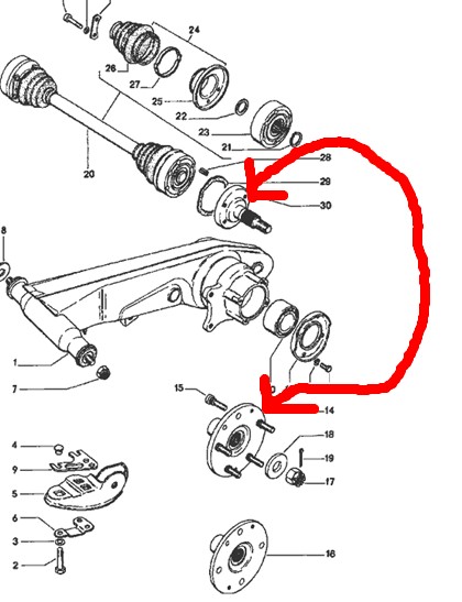

Can you flat tow a 914 w/o the engine/transmission installed? How would you keep the axles from flopping around? You could pull them, but I think thats certain death for the bearings.

i think you want both these parts on the swing arm, held on with the castle nut, for flat towing.

jimkelly   i think you want both these parts on the swing arm...   Sep 25 2012, 06:20 PM
SLITS   Yup! Reason: The stub axle supports the back...   Sep 25 2012, 08:07 PM
Brett W   I flat towed a 914 from Colorado to Alabama with s...   Sep 26 2012, 12:39 PM
