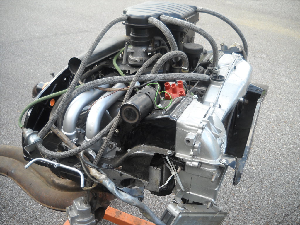

hot_shoe914
If Zach can get his 914 to Scotty's party I am bringing him a motor that is basically plug and play that all the drunk people can install into his car.
drunk.gif drunk.gif drunk.gif drunk.gif drunk.gif drunk.gif drunk.gif drunk.gif
