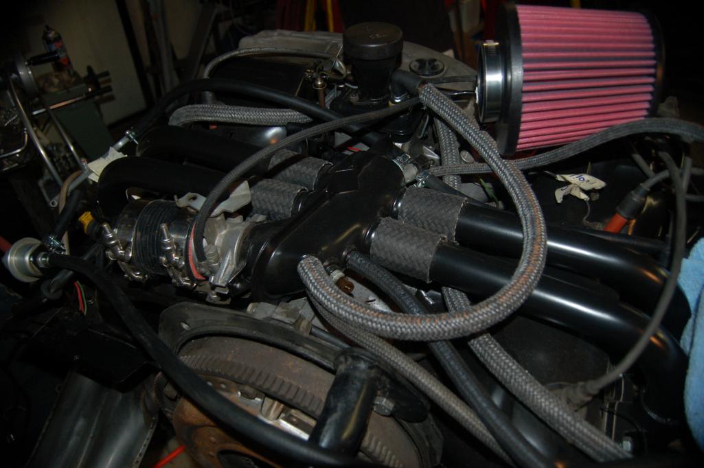

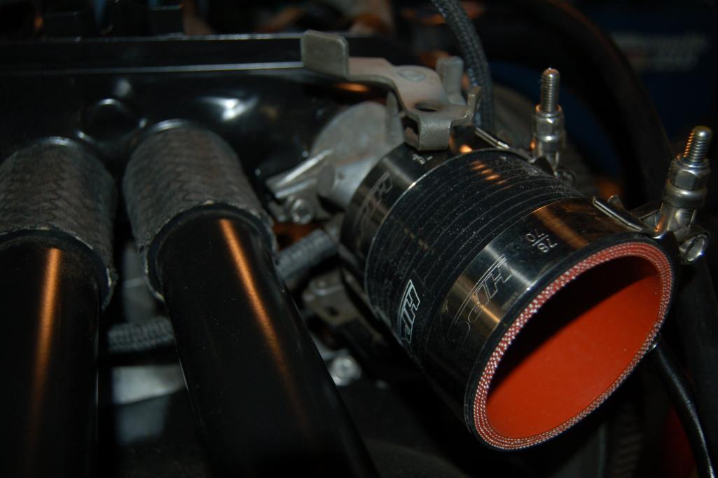

I don't want to reinstall the org air cleaner housing and hide the nice clean engine. So heres what I'm doing, silicone coupler, stainless clamps, stainless pipe, and cone air filter. The first pic is the coupler and the second is tring to decide where I want the air filter to end up.

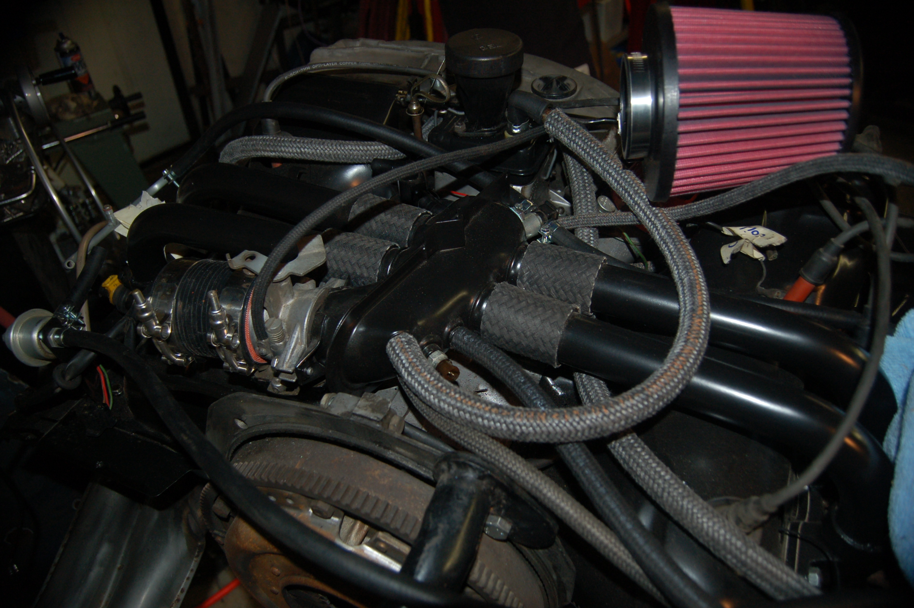

metalmorphosis   I don't want to reinstall the org air cleaner ...   Sep 28 2012, 10:11 PM
metalmorphosis   So heres what I've come up with. I still have ...   Sep 28 2012, 10:22 PM
