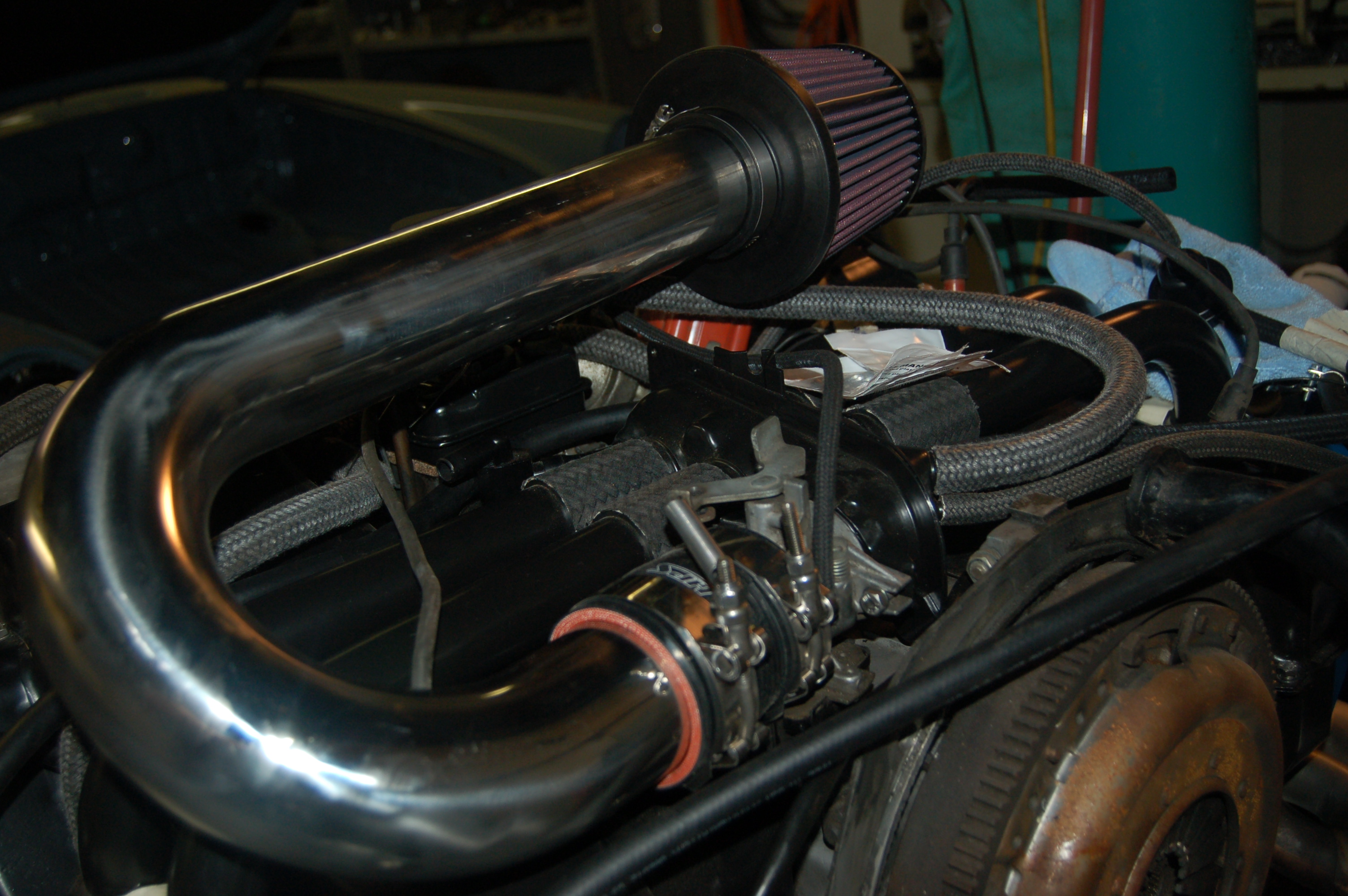

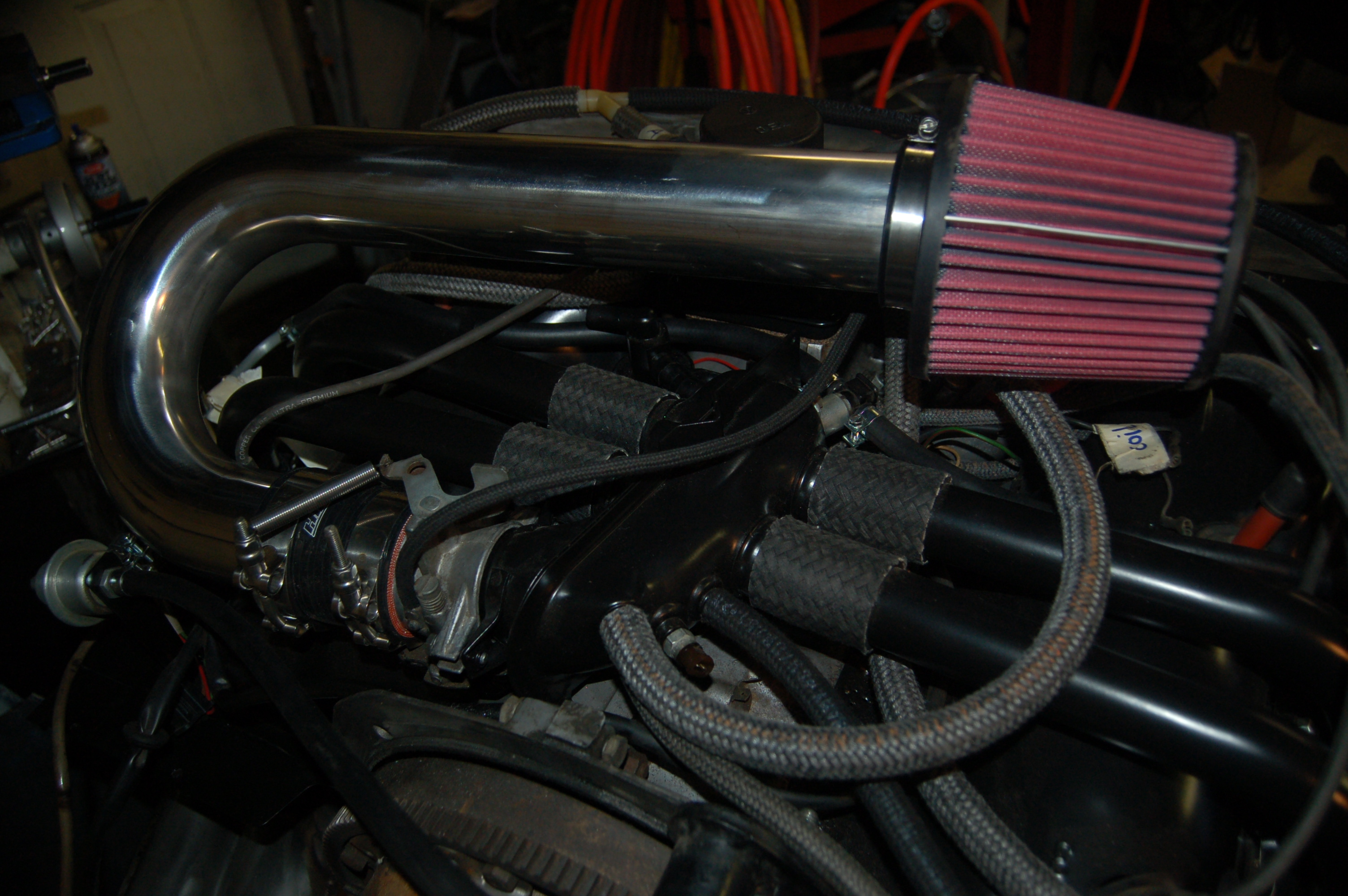

metalmorphosis   I don't want to reinstall the org air cleaner ...   Sep 28 2012, 10:11 PM
metalmorphosis   So heres what I've come up with. I still have ...   Sep 28 2012, 10:22 PM
metalmorphosis   last one for tonight   Sep 28 2012, 10:28 PM
