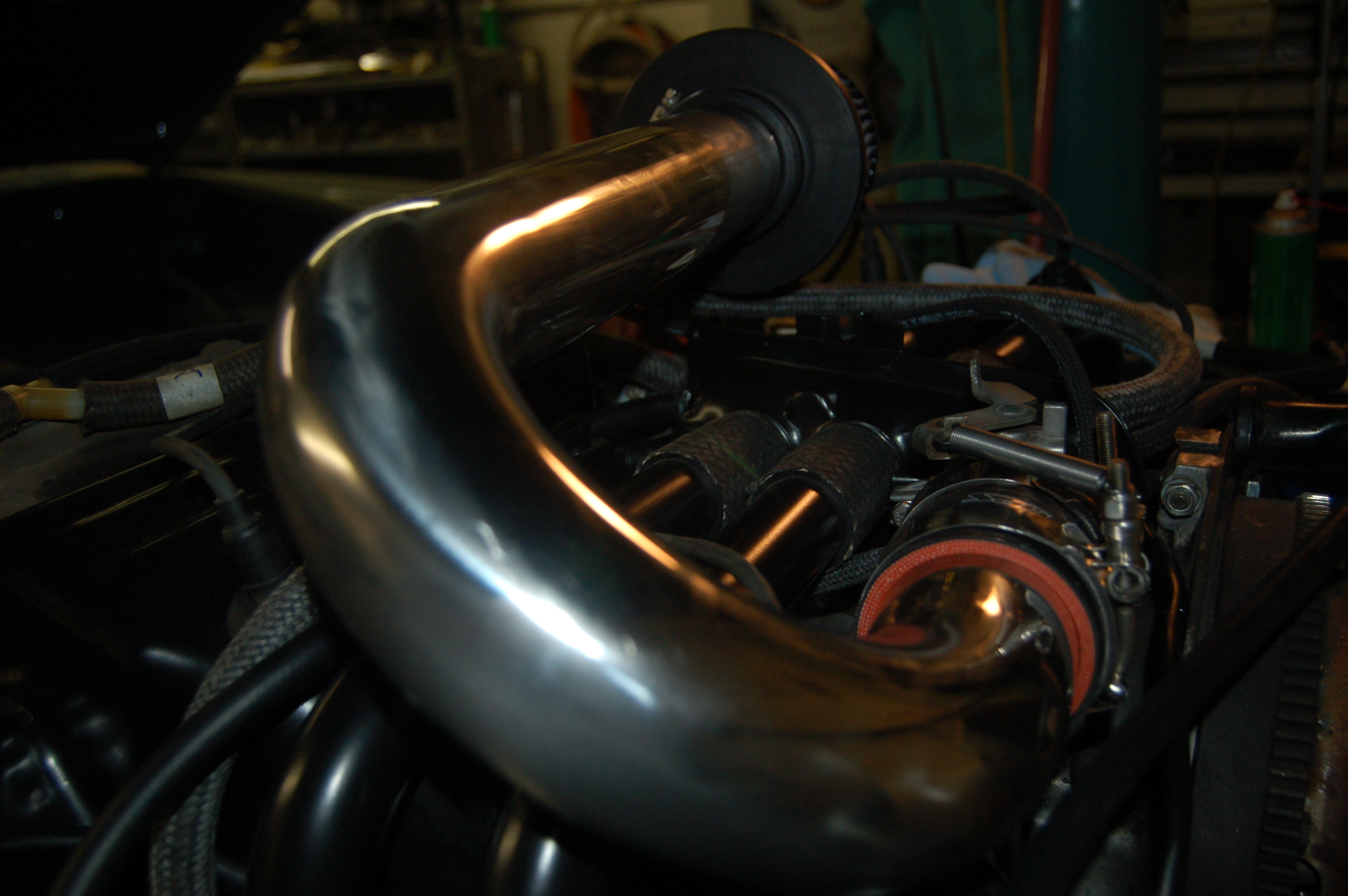

metalmorphosis   I haven't posted anything lately so its time t...   Sep 28 2012, 09:57 PM
metalmorphosis   Heres some fuel pump and stainless line action   Sep 28 2012, 10:00 PM
metalmorphosis   I don't want to reinstall the org air cleaner ...   Sep 28 2012, 10:11 PM
metalmorphosis   So heres what I've come up with. I still have ...   Sep 28 2012, 10:22 PM
metalmorphosis   last one for tonight   Sep 28 2012, 10:28 PM
