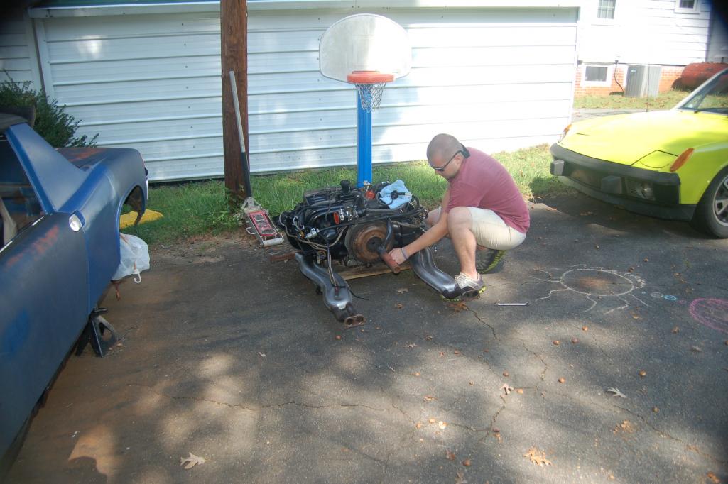

Hello 914 world! Ive been lazily lurking here for way too long and finally decided
to change that tonight. So heres my 1st contribution to all this 914 awesomeness.
This is my 914 back in 2010 when I started the rust repair. I'm almost done with
rust repair now and I have lots of pics but I have to resize and post latter. It seems like these pics are gonna work even though they are big so I guess we'll see what happens.

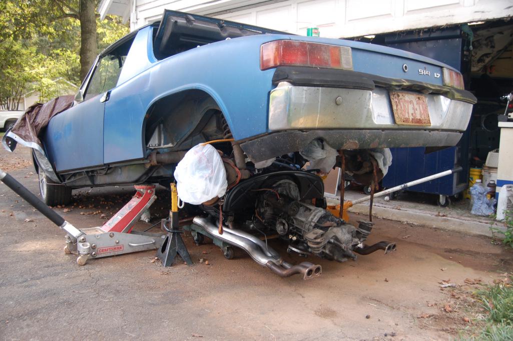

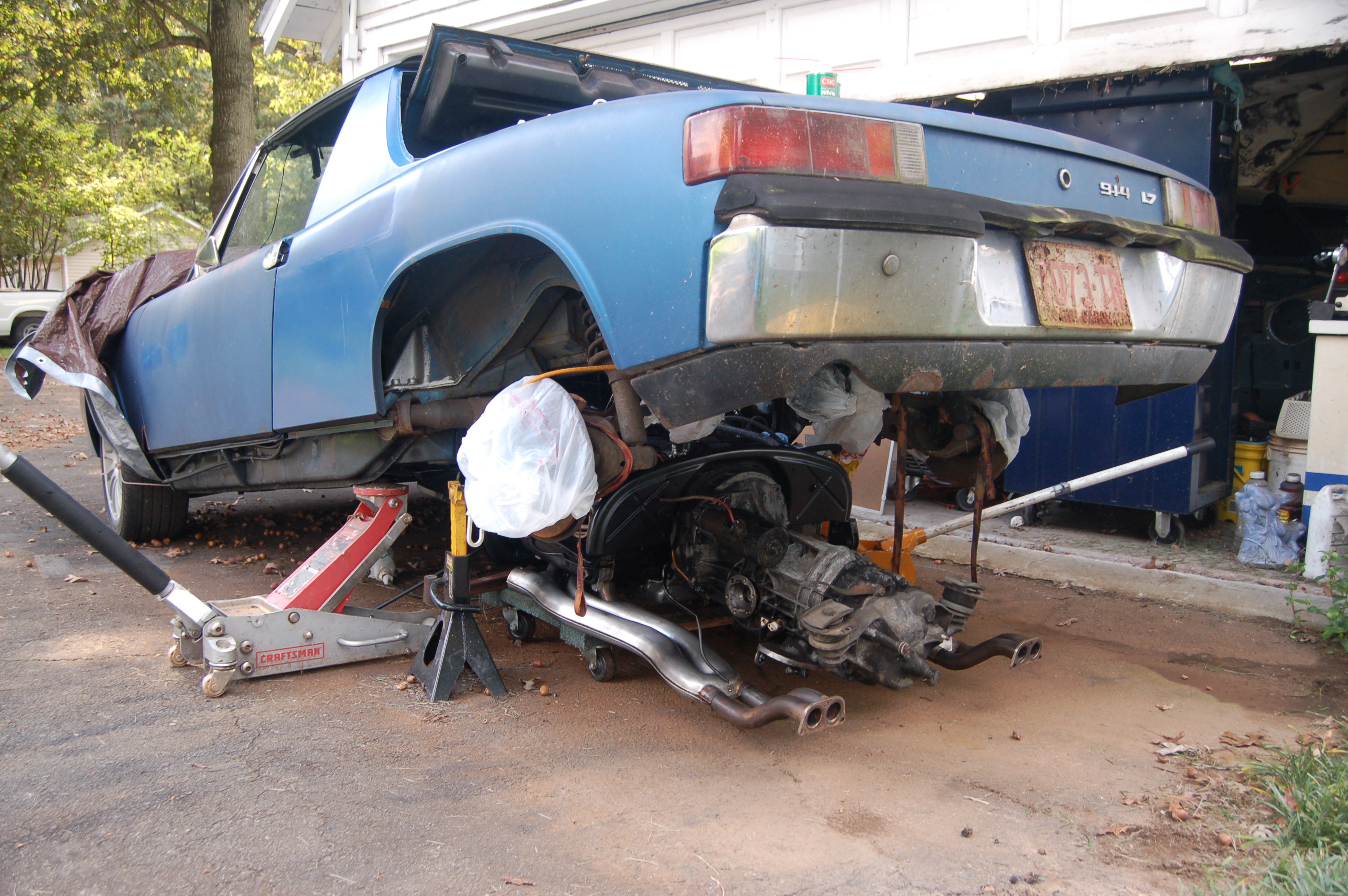

So today was the day for the motor to go back in my car!!!!!!!!!!!!! After 2 long yrs of rust repair I'm almost done w this phase of my 914 project. Doug was kind enough to come over and help me w the installation, thanks again Doug! Now all I have left to do is get the gas tank boiled out and reinstalled, the rear window and shift linkage, and a few wires and cables. Of course there are tons more to be done to this car like the interior and bodywork and paint, but those things will be later. So enough with the talkin here comes the pics.
