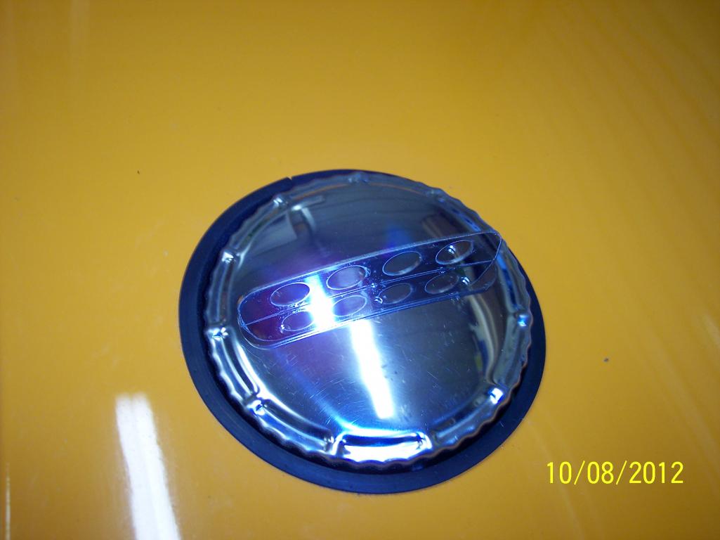

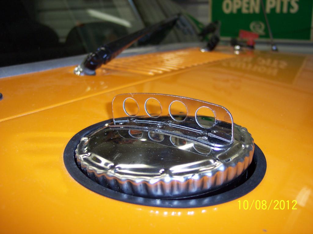

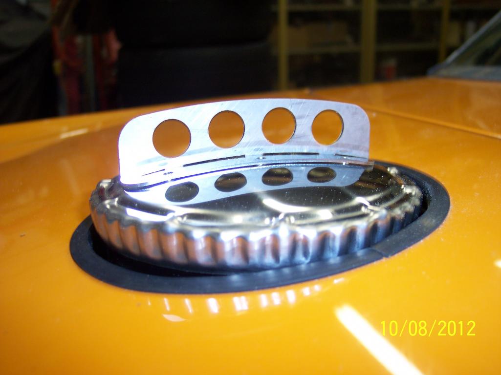

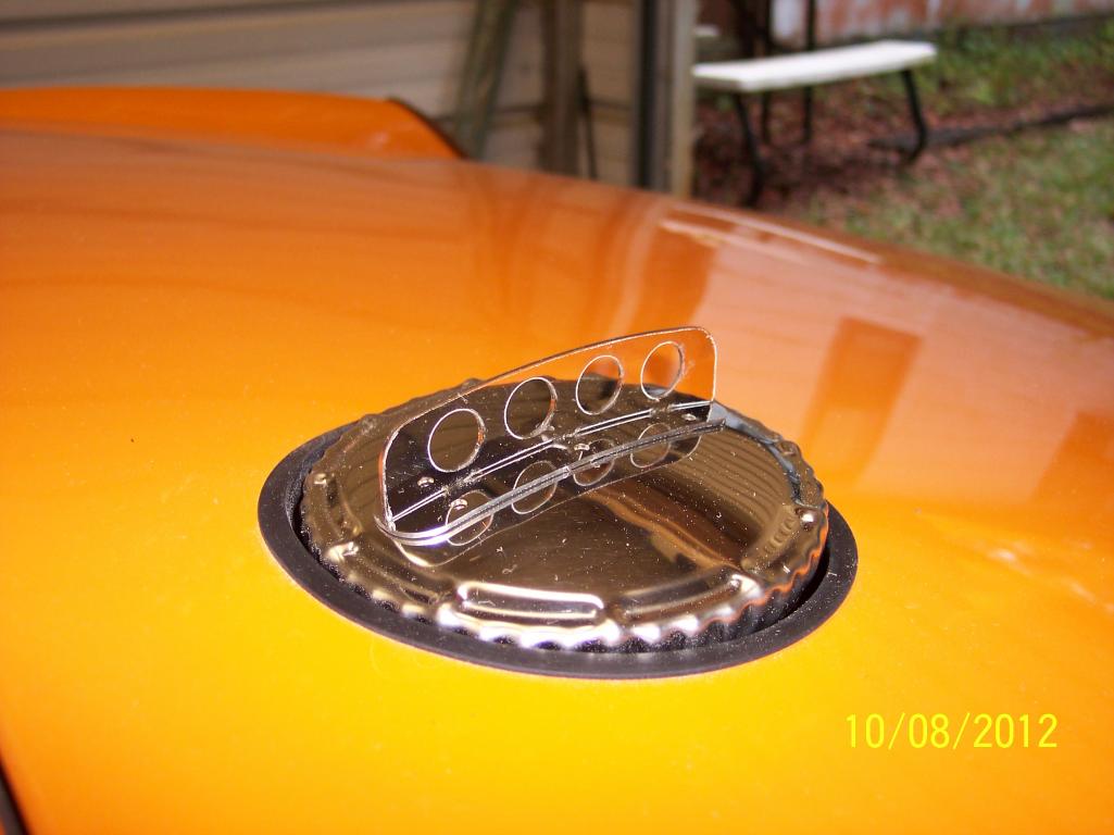

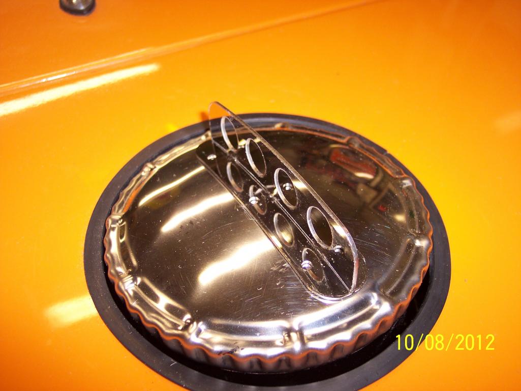

It has taken a while to get a couple of designs lasered but here are the 2 I've settled on.
One design is a curved top, and the other design has a flat top. Both are 4 hole designs.
The material is .048 thick stainless, came mirror polished on one side.
Please give me some feedback, good or bad. Does it look to weak??, too heavy??
In the pics, nothing is welded up yet. Pieces are just sitting there loosely.
I also will post pics soon of 2 of the standup parts back to back, sitting on the base for more feedback.
Ron
