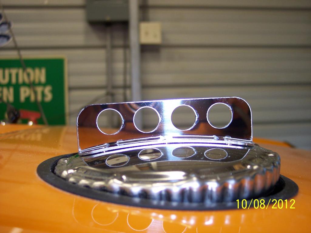

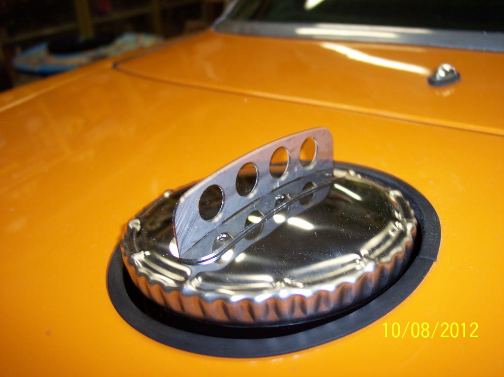

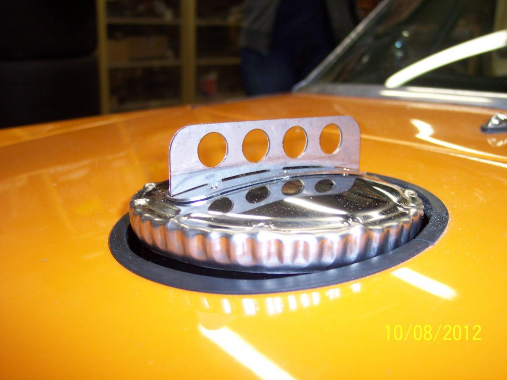

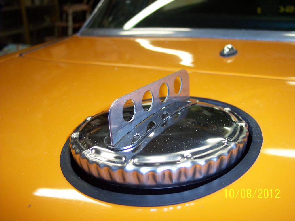

I took several shots because the reflectivity of the finish seemed to make the parts look transparent..
Here are some more curved, then the flat handles.
