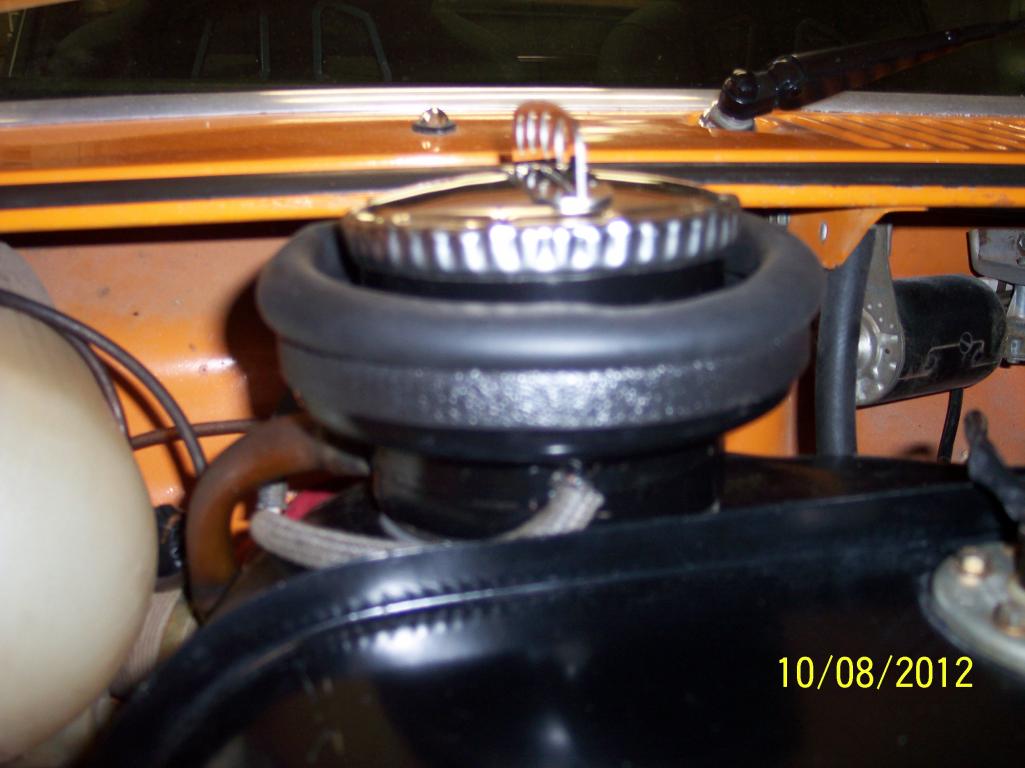

My next project for the rocket will be to convert the Fuel and oil caps over to the Blau 110mm for the fuel, and 80mm cap for the oil tank.
I just received these caps today from a guy over in Europe. I answered an old posting in the classifieds over on the bird board, and I shocked that he still had a few sets left. I got the caps and the filler necks. The Fuel cap is as received, and is actually polished Stainless Steel. The oil cap is polished Aluminum. Both are genuine Blau caps as stamped on the bottom. Made in Austria.
The caps in the pics are just laid there for size reference.
On the fuel side I am going to have the fuel cap go up through the hood, and have a locking gas gap hidden below the Blau cap when it is removed. The Blau gap will be secured with a lanyard to keep it from getting stolen. I'm going to raise mine up high enough so the cap is level with the hood line.
On the oil side I'll probably butcher up a 911 oil inlet to mount the cap to.
Both caps will have a handle made to remove them easily like the GT units. This looks to be a good fall project.

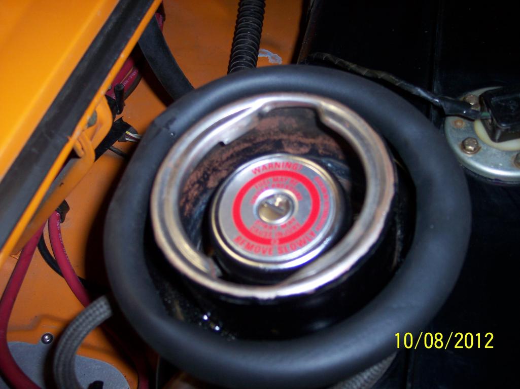

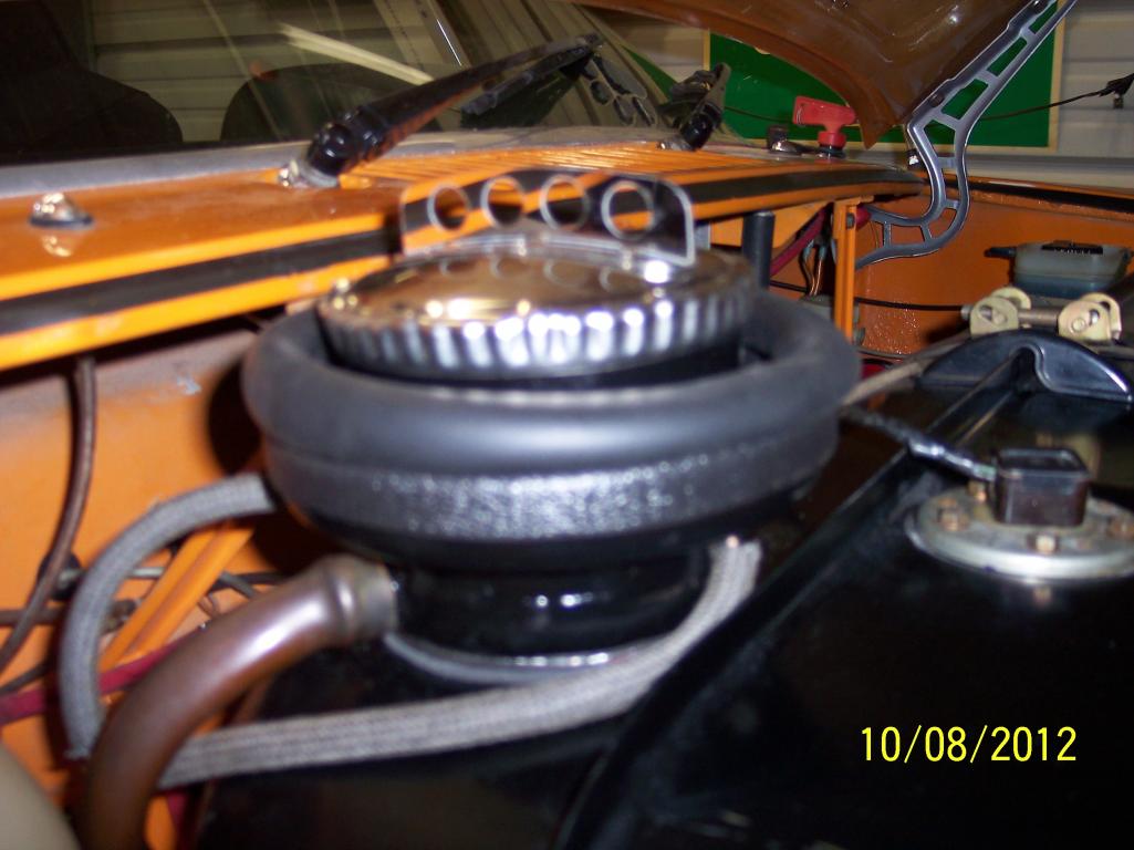

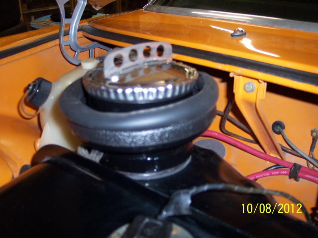

I thought I should post some pics of the finished filler..
Sorry if they are Blurry....
You can't see it, but I also took a stainless steel sink strainer from Lowes, and modified it to fit below the bottom gasket.
I put it there to stop anything from falling into the tank with the cap off.
