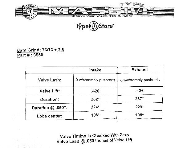

The title says it all. I am rebuilding starting with a 2 liter engine - actually a 1,7 case, but 2 liter crank and heads. Need help choosing a cam for Stock FI. I like the stock FI, and perhaps should have stayed with the original displacement, but I want a wee bit more power.
Actually I want a lot more power, but that is why I also have the 3.2 in the background.
Advice about cams for a 2056 build and also about oil pumps would be much appreciated. Also, I really do want to not go the carb route. Thanks!

Ask Webcam or other web grinders for this profile.
