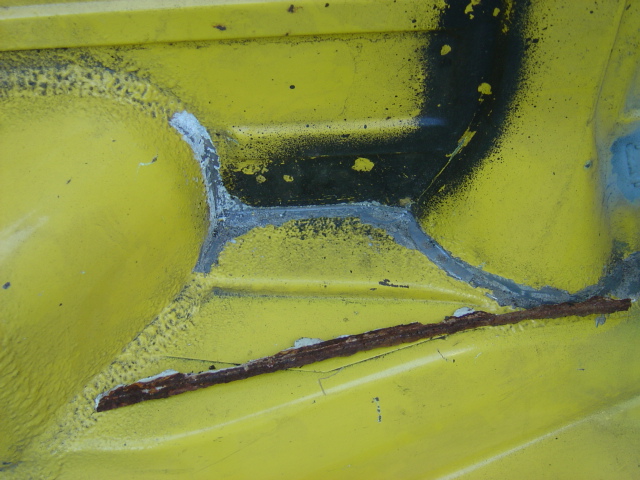

Spent most of the weekend trying to clean up the rear trunk seam and floor area. Discovered the seam sealer by the taillights and latch was holding water like a sponge and causing rust. This is a chunk of the seam sealer after it has been pealed out and flipped over. More crap to remove. Everyone, what is your best technique to get rid of the seam sealer?

william harris   Spent most of the weekend trying to clean up the r...   Jun 13 2004, 09:26 PM
william harris   I'm sure my techinque is a little different, I...   Jun 13 2004, 09:29 PM
william harris   I can't believe how thick this crap is! I...   Jun 13 2004, 09:30 PM
william harris   I've learned that any place on the car with PO...   Jun 13 2004, 09:33 PM
william harris   Here's the same area from the other side. Rac...   Jun 13 2004, 09:35 PM
william harris   Question for the group: how far should I go in re...   Jun 13 2004, 09:38 PM
Racer Chris   I'm looking William. I'm surprised to see ...   Jun 13 2004, 09:41 PM
william harris   Since the weather was good, I also took the time t...   Jun 13 2004, 09:42 PM
Racer Chris   I say remove as much sealer as you can in as many ...   Jun 13 2004, 09:50 PM
