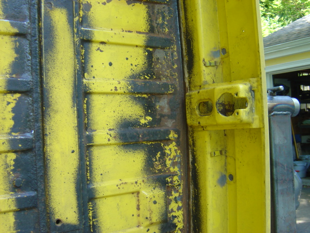

william harris   Spent most of the weekend trying to clean up the r...   Jun 13 2004, 09:26 PM
william harris   I'm sure my techinque is a little different, I...   Jun 13 2004, 09:29 PM
william harris   I can't believe how thick this crap is! I...   Jun 13 2004, 09:30 PM
william harris   I've learned that any place on the car with PO...   Jun 13 2004, 09:33 PM
william harris   Here's the same area from the other side. Rac...   Jun 13 2004, 09:35 PM
