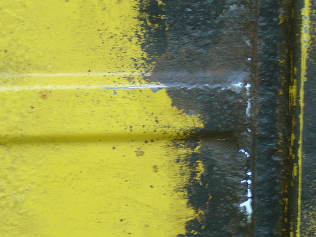

I've learned that any place on the car with POR15 black paint is a problem area. Wire brush and scraping around this area revealed minute penetration thru the floor at the weld at the reinforcing piece. Racer Chris, what's the best repair here? Lay down and weld over these pin holes?

william harris   I've learned that any place on the car with PO...   Jun 13 2004, 09:33 PM
william harris   Here's the same area from the other side. Rac...   Jun 13 2004, 09:35 PM

Racer Chris   I'm looking William. I'm surprised to see ...   Jun 13 2004, 09:41 PM

william harris   6/14/04 at 8:18 p.m. EST: Racer Chris: After we ...   Jun 14 2004, 06:20 PM
william harris   Pin holes don't vizualize very well inside the...   Jun 14 2004, 06:23 PM
