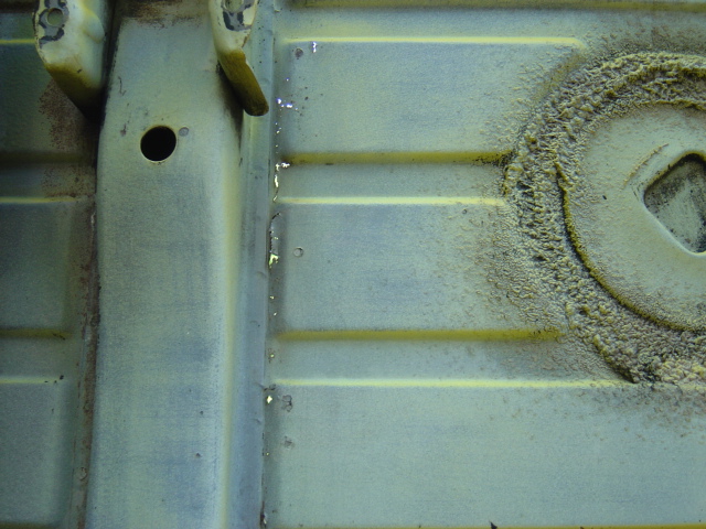

william harris
post Jun 13 2004, 09:35 PM
914 Restorer
Posts: 1,459
Joined: 9-January 04
From: Hamilton, MA
Member No.: 1,539
Here's the same area from the other side. Racer Chris, please PM or call me with your recommendations.
