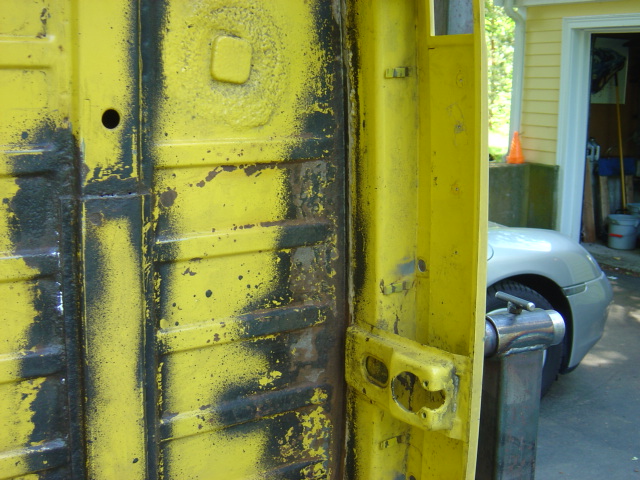

Question for the group: how far should I go in removing this seam sealer? As you know it is everywhere. Most areas seem good, but I am now worried what is under this stuff. After about 2 hours here is what the trunk area looks like now.

william harris   Question for the group: how far should I go in re...   Jun 13 2004, 09:38 PM
Racer Chris   I'm looking William. I'm surprised to see ...   Jun 13 2004, 09:41 PM

Racer Chris   I say remove as much sealer as you can in as many ...   Jun 13 2004, 09:50 PM
