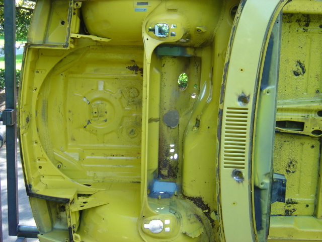

Here's the front trunk.

william harris   Question for the group: how far should I go in re...   Jun 13 2004, 09:38 PM

Racer Chris   I say remove as much sealer as you can in as many ...   Jun 13 2004, 09:50 PM
McMark   Front trunk springs are easy. Get a ViceGrip or p...   Jun 13 2004, 09:55 PM
william harris   Here's the front trunk.   Jun 13 2004, 09:56 PM
