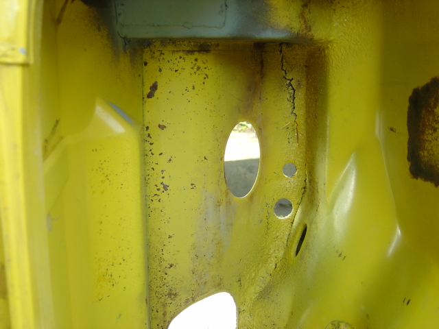

william harris   6/14/04 at 8:18 p.m. EST: Racer Chris: After we ...   Jun 14 2004, 06:20 PM
william harris   Pin holes don't vizualize very well inside the...   Jun 14 2004, 06:23 PM
william harris   Another view from the bottom.   Jun 14 2004, 06:25 PM
william harris   Here's the last one from the inside of the tru...   Jun 14 2004, 06:27 PM
