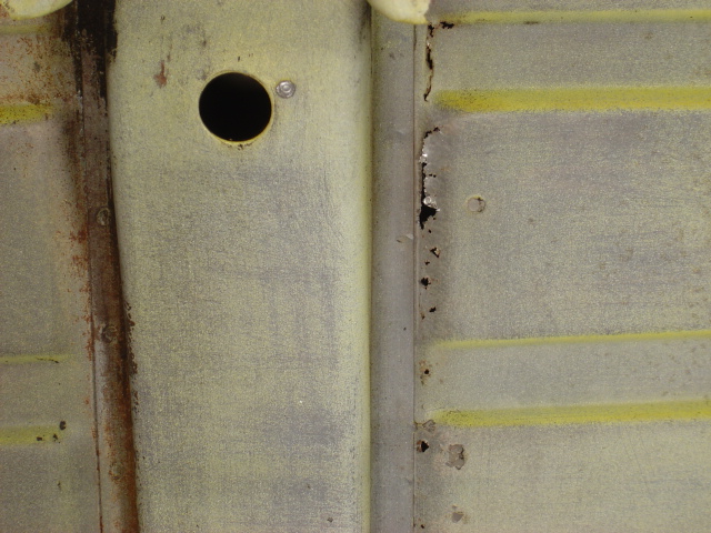

Pin holes don't vizualize very well inside the garage. Much better view from the inside.
