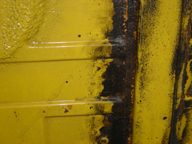

Here's the last one from the inside of the trunk. Let's go ahead and plan for you to make the repairs. Bring your gear and lunch is on me. Early Saturday would be good. Call me at the office tomorrow.
