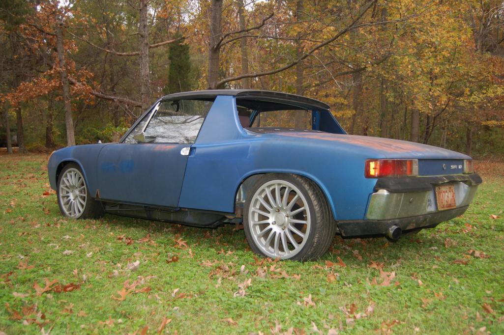

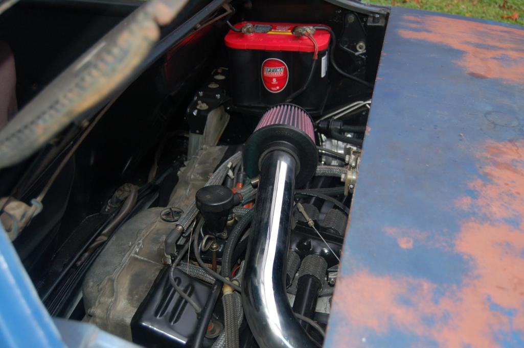

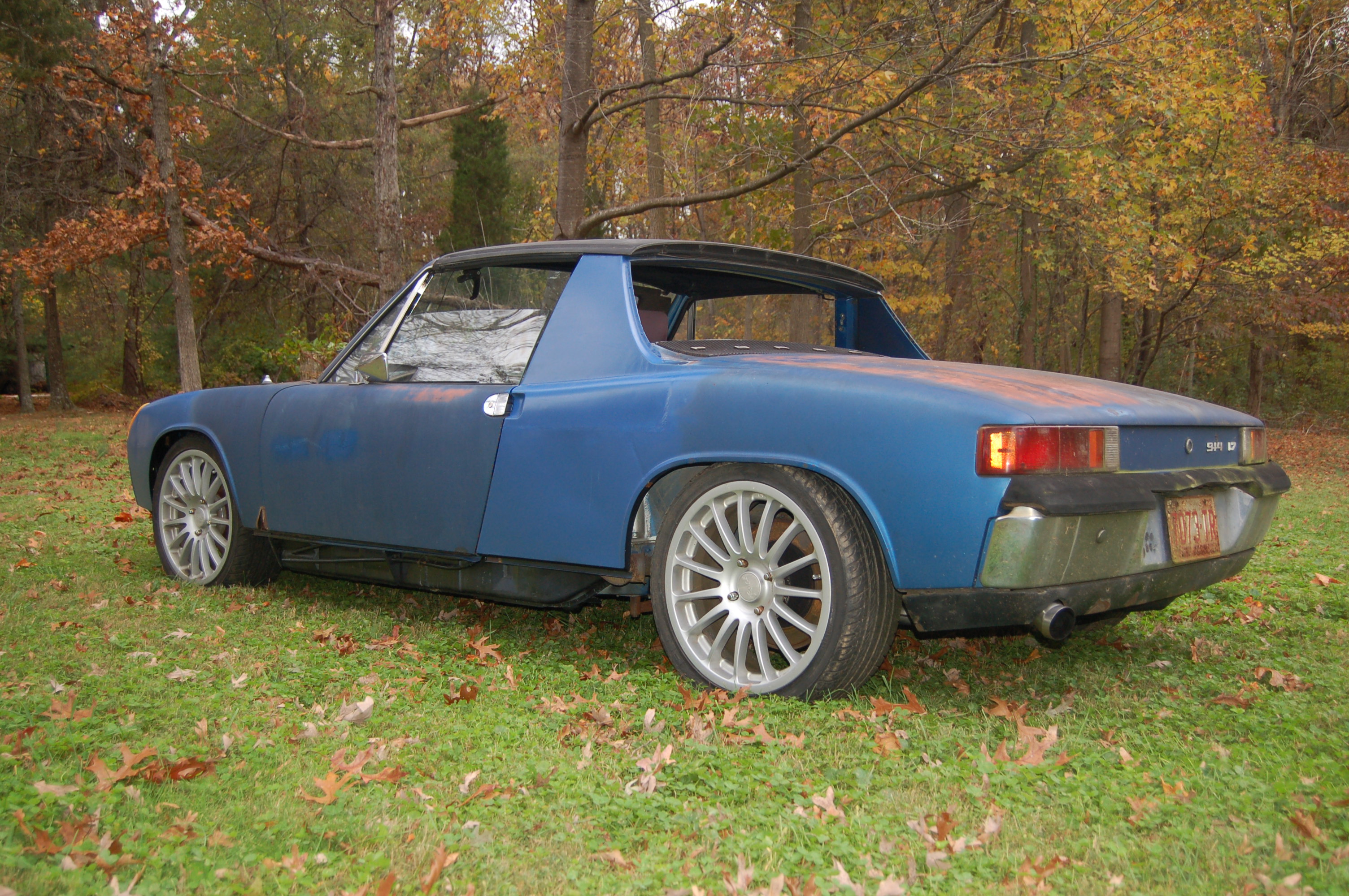

metalmorphosis   I haven't posted anything in about a month but...   Nov 5 2012, 12:12 AM
metalmorphosis   Also I found some pics of my old fastback that was...   Nov 5 2012, 12:19 AM
metalmorphosis   I DROVE MY CAR TONIGHT!!!!!...   Dec 8 2012, 08:27 PM
