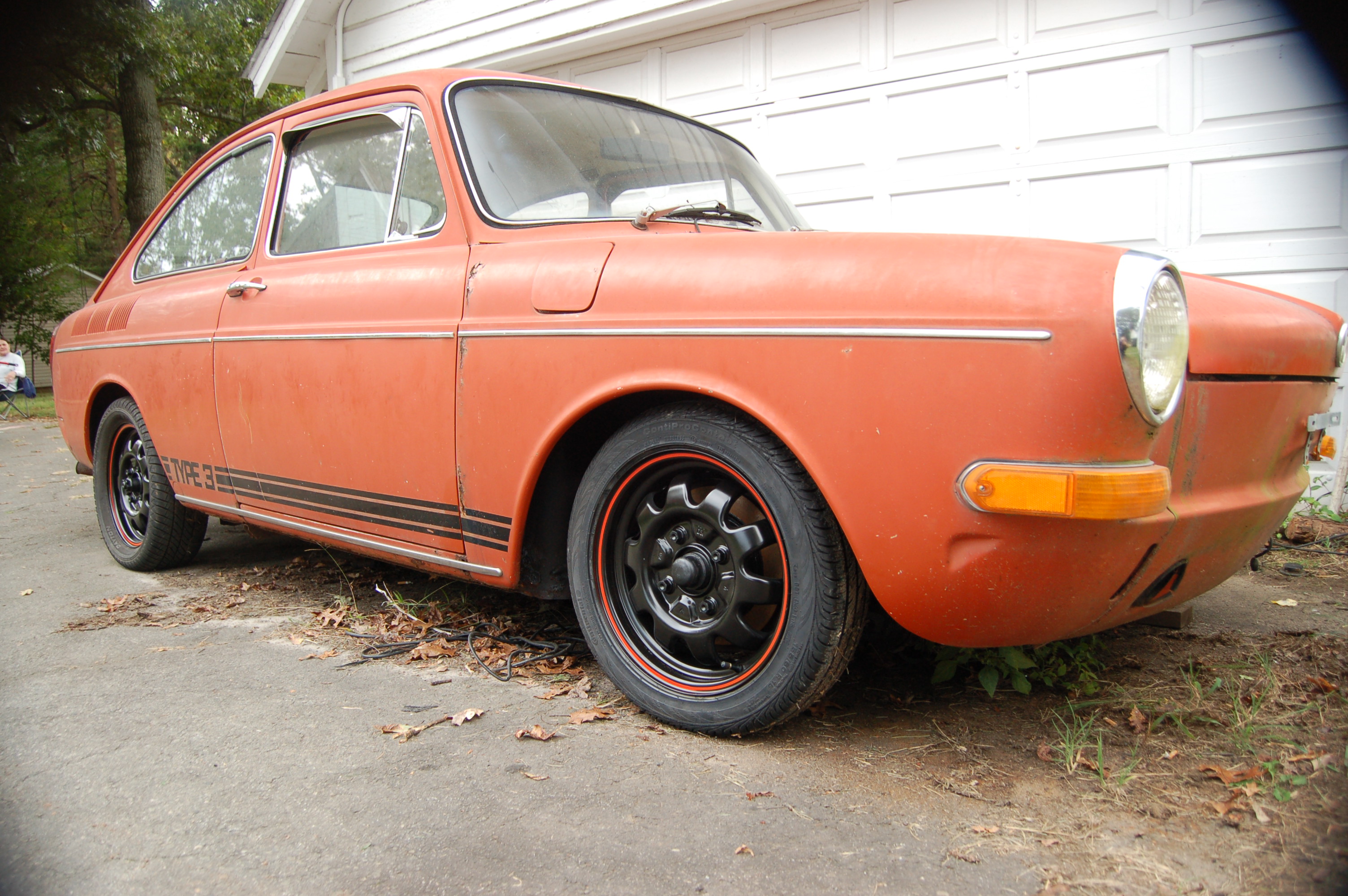

Also I found some pics of my old fastback that was mentioned eariler so heres my last one for tonight.
