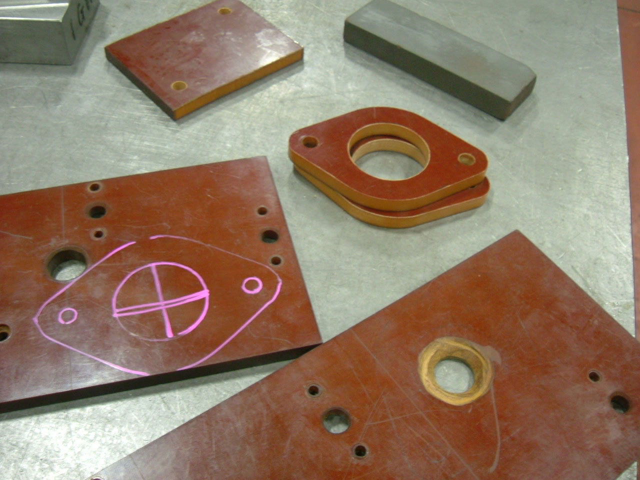

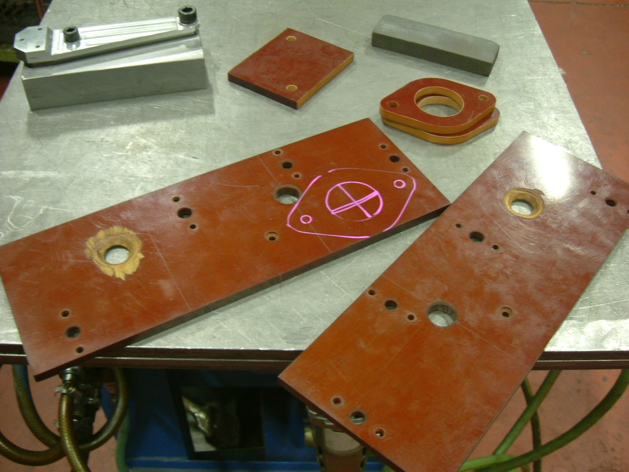

Ok, here are some pictures as promised. I finished one set this week.
Picture one shows the material I am using which may be bakelight...I actually got it for free from our spot welder operator as he no longer needed it. Thats how I got it with the holes in it already.
Another one but close up. Is this really bakelite or is it Phenolic? I believe they are the same material.

QUOTE(nsr-jamie @ Nov 9 2012, 08:38 AM) *
You're right, they're the same (http://www.professionalplastics.com/BAKELITE). You couldn't machine the original bakelite, it was always molded, but now it's now made with different reinforcing materials, paper, canvas and linen, that make it machinable.
Right about the Dellorto whistle, too. CB Performance sells a spacer/gasket that covers that gap and eliminates the chirps.

QUOTE(DBCooper @ Nov 10 2012, 01:51 AM) *
Right about the Dellorto whistle, too. CB Performance sells a spacer/gasket that covers that gap and eliminates the chips.
Do you happen to know the part number for this CB performance part? I have been looking over their site and have not found anything....perhaps I am looking in the wrong area.
I was thinking about going with two sets of paper gaskets and sandwhich my new bakelight spacers in between.
