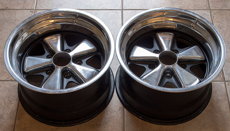

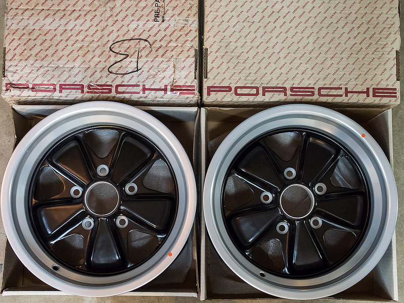

Well my g'damn car is still not home yet but there is forward motion. We ended up getting around the front clearance issues by going back to 15" wheels and the resulting shorter tires. (This will save a little weight too.)
Accordingly I just picked up 2 pairs of NOS 15x8's and 1 pair of 15x9's. I can also run the 16x9's I already have on the rear.
(IMG:http://www.914world.com/bbs2/uploads_offsite/farm9.staticflickr.com-21-1353193390.1.jpg)
15x8" Porsche Fuchs wheels by cjcam, on Flickr
(IMG:http://www.914world.com/bbs2/uploads_offsite/farm9.staticflickr.com-21-1353193390.2.jpg)
15x9" Porsche Fuchs wheels by cjcam, on Flickr
I will most likely send them to Weidman for the RSR 'frosted' finish.
