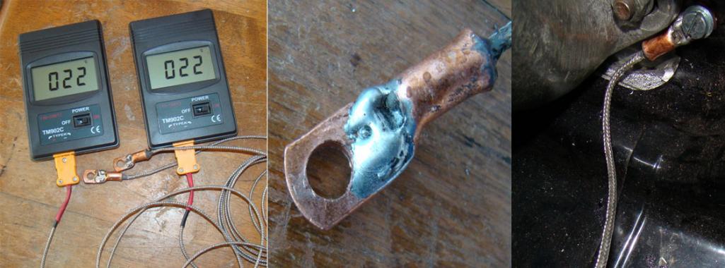

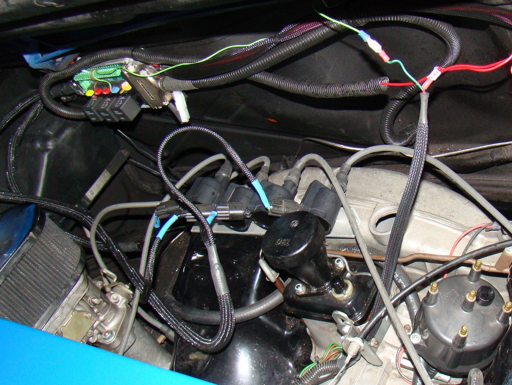

Here is a photo of the temporary coil setup and look the distributor wires are gone.
and some photos of my head temp sensor setup....lest than $25 for both on ebay!
