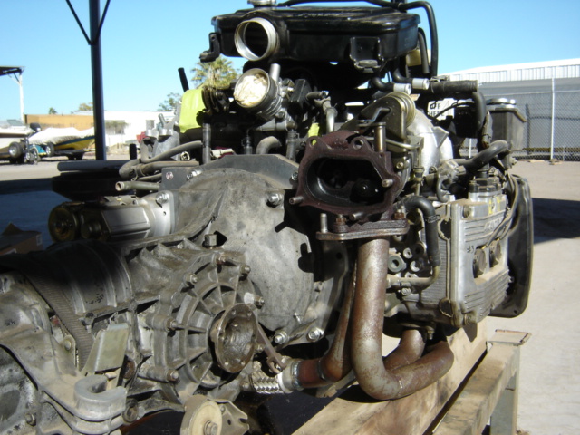

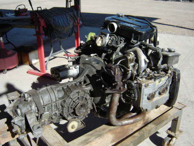

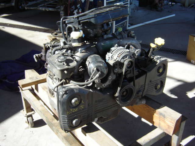

So I got the motor a trans out of storage. I am think of going air to water to air for the innercooler. I have one of a JDM,its in the photo. Think it is on a 220 HP motor.????

904svo   When I put a Subaru 2007 wrx engine in my kit car ...   Nov 20 2012, 05:19 PM
914GTSTI   Thanks 904! Think I will stay with water. Up f...   Nov 20 2012, 10:45 PM
