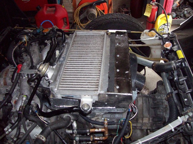

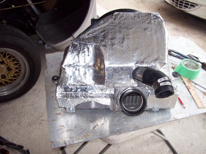

When I put a Subaru 2007 wrx engine in my kit car I ran into the same problem.
I installed a 7" fan which pulls the air through the cooler and exhaust the air to the transmission area, the fan is control by the VSS sensor, when it pulses it turns on the fan. Here are some pictures of it.
