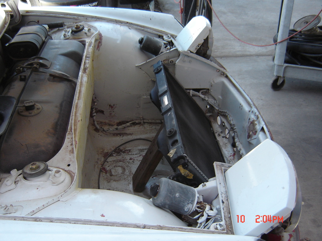

Up front I have lots of room for a heat exchanger for the intercooler.
Been working out the Rad. for the motor and will just ad a Rad. for the exchanger. Thinking a 24" by 12" by 1" would do the job?
