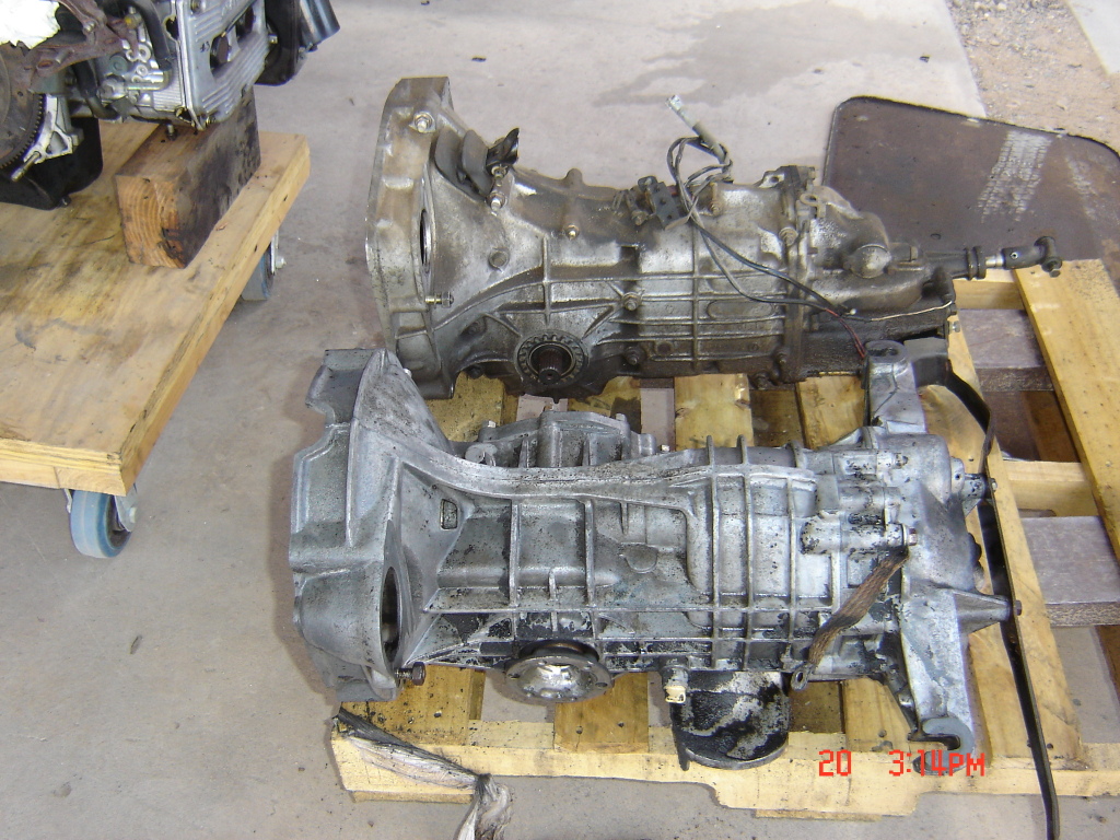

Some one was asking,some time back what the FWD trans looked like. Here is a photo of the 914 and the FWD Subaru tran's. Is that a word? LOL
