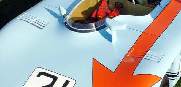

Don't know about the venting? Was thinking about something like this.
(IMG:http://www.914world.com/bbs2/uploads_offsite/i916.photobucket.com-8123-1353808504.1.jpg)
