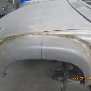

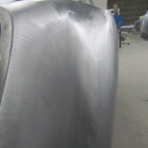

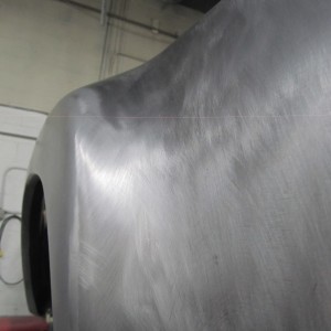

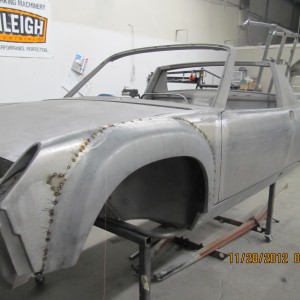

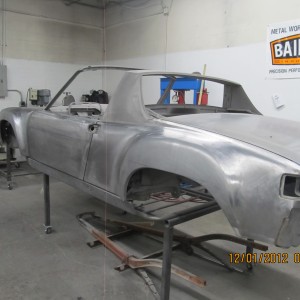

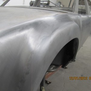

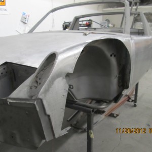

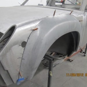

continuation of grafting....
Front LH fender to get the real feel of the conversion.
I tack with the MIG, but TIG weld the panel in as i can control the heat source.Mig is more of a brittle weld on sheet metal in comparison to TIG.
