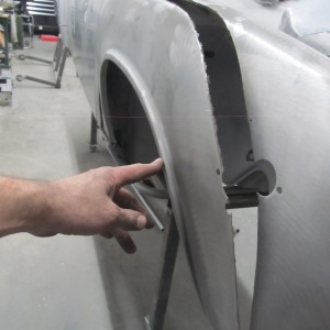

Front RH fender/arch removal
(IMG:http://www.914world.com/bbs2/uploads_offsite/www.themetalsurgeon.com-14902-1354488345.1.jpg)
'know whats under your paint'.....
