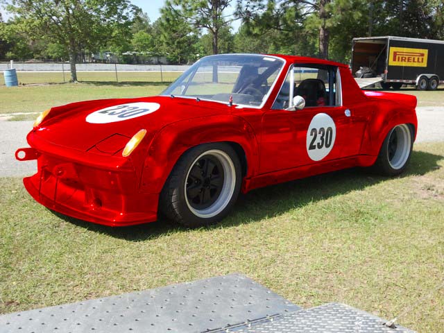

QUOTE(SirAndy @ Dec 3 2012, 12:23 PM) *
Quick mockup in red with red bumper ... (IMG:style_emoticons/default/popcorn[1].gif)
