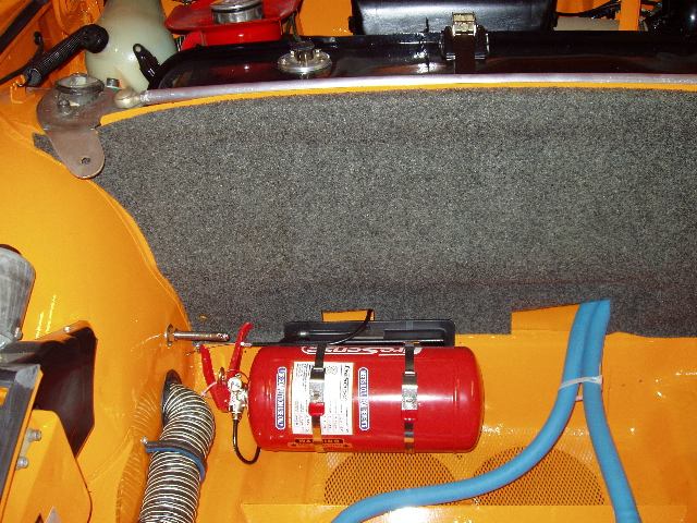

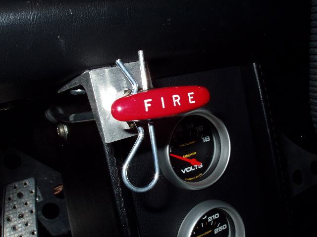

ellisor3   Here is link to some fire supression systems. htt...   Dec 4 2012, 05:10 PM

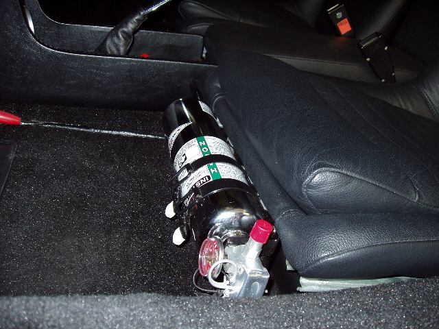

RickS   A halon extinguisher is the next best thing to a f...   Dec 4 2012, 09:05 PM

GeorgeRud   Halon has the least cleanup, but foam is probably ...   Dec 4 2012, 10:07 PM

montoya 73 2.0   It looks as though they used foam on that Teener. ...   Dec 4 2012, 11:29 PM

montoya 73 2.0   I replaced my home extinguishers (powder) to CO2. ...   Dec 7 2012, 10:48 PM
Dr Evil   CO2 removes O2 and heat from the equation so as lo...   Dec 8 2012, 12:07 PM
