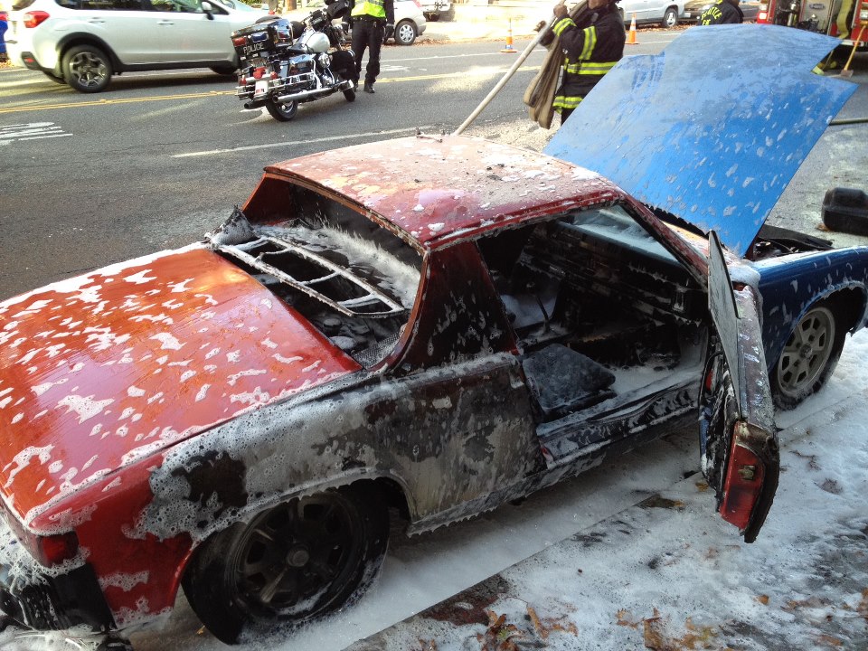

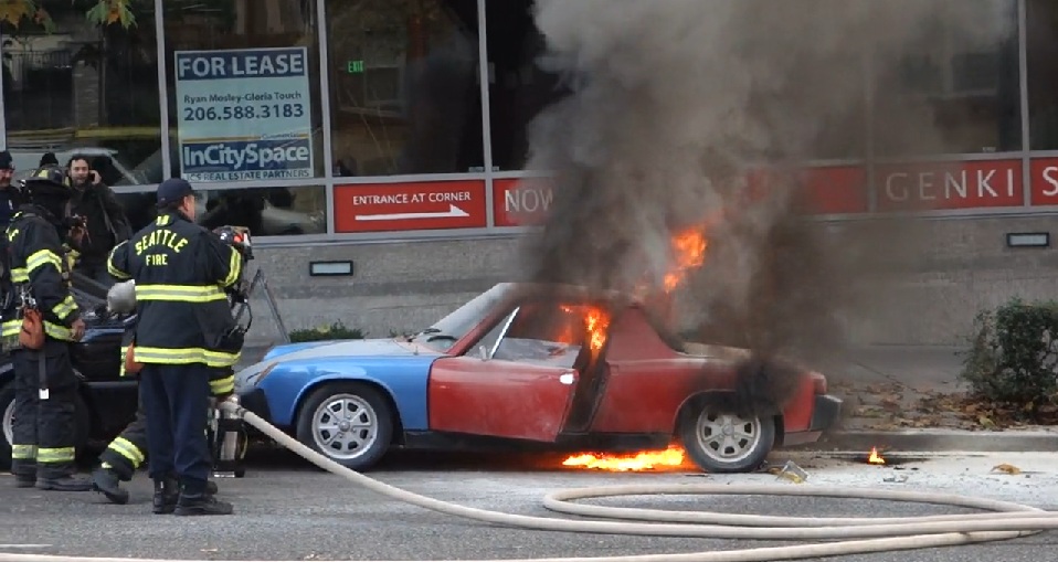

Has this ever happened to you?
Video of car on fire: https://www.facebook.com/photo.php?v=10151125433882341
This is an unfortunate, serious reality and real danger for us 914 owners that tragically happens all too often. But why and how can it be prevented?
I'd like to propose three talking points that could help educate other 914 owners to make necessary precautions to preserve their cars - and their lives:
1. What causes fires in the 914 and why are they so common?
2. What precautions may be done to prevent a 914 from catching fire?
3. If your 914 does catch fire, should you try to put it out or should you stay away in case of an explosion?

I actually watched one go up in flames while it was sitting at a traffic light. Car was idling fine, and then smoke appeared out of the engine compartment. The smoke increased, gas began pouring out from under the engine, and flames gradually appeared out of the intake grill.
Engine kept idling fine. Owner looked in the rear view mirror, did a double take, and jumped out of the car.
The rain tray began melting and burning and dropped in. The owner tried to open the engine intake grill- but by then, the latch quit working.
Flames shot out of the grill, the owner opened the trunk and pried the intake grill open with a crowbar.
Flames really shot out and the gas under the car caught fire....
The owner backed up, and finally killed the engine (which was running fine). By then, the fuel lines were broached under the car, and gas kept pouring out from underneath.
The flaming gas pool under the car increased, and caught the rear tires on fire. The flaming rear tires began to expand as the air inside heated. The rear of the car rose up as the tires got giant sized, and one by one, the rear tires blew.
The fire department arrived, and put it out with foam. At no time did I see any energetic magnesium burns.
I believe that a fuel line or injector J tube split on top of the engine, or a hose clamp let go. That sprayed a small stream of gasoline across the warm engine, and eventually it caught fire. Once the fire got going, the upper fuel line ruptured (after the pressure regulator?) to pour gas onto the top of the engine and under the car. The fuel pool under the car eventually caught fire and burned out the lower rubber fuel lines and/or gas filter. Once the lower hoses failed, there was no stopping the gravity fed fuel pouring from the gas tank.
Considering the number of cars I‘ve seen with petrified wooden-like rubber fuel lines or cheap assed low pressure fuel lines, it's a wonder more don't go up.
Cheap insurance is replacing 20-40 year old rubber fuel lines and injector "J" hoses, making sure that all fuel line clamps are the factory recommended ones (rolled edges) and that all clamps are tight. And don't cheapen out. BUY THE EXPENSIVE BUT SAFE HIGH PRESSURE FUEL LINE.

It looks as though they used foam on that Teener. I personaly had my teener catch fire but it was in the steering column. Back in 1998 when my pops owned the car, I was driving it because my bus wasn't working. The wipers didn't work at the time due to a bad motor. I must have accidentally turned the wipers on when making a turn and never turned them off. As I was a block away from home i smell burning plastic and then smoke started pouring out of steering column. Luckily the p.o. before my pops installed a halon 2.5 lb extinguisher in the cab. I reached over while driving grabbed the extinguisher, reached down under the dash and squeezed the trigger a few times then brought it up in front of me and squeezed a few times. Luckily it was a warm day in san jose california that day so I had my window down cause it got cloudy and halon sucks the o2 out of the direct area. It went out and I had reached home and turned it off. We had it towed to the shop in fremont and thats when we found out it was due to a electrical fire. So it is not always a gas fire.
Also, back in the 80's we would go to boney dunes near santa cruz and use a old 36 horse vw motor block that is magnesium in the center of the wood pile and light it up! That block would glow and you would have to stand a good 15 to 20 feet away. I bet it could turn some of that sand into glass. Magnesium won't light up in solid form unless it in a prolonged very hot fire but it will in shavings or dust form as in a machine shop situation. Atleast thats in my experience.
