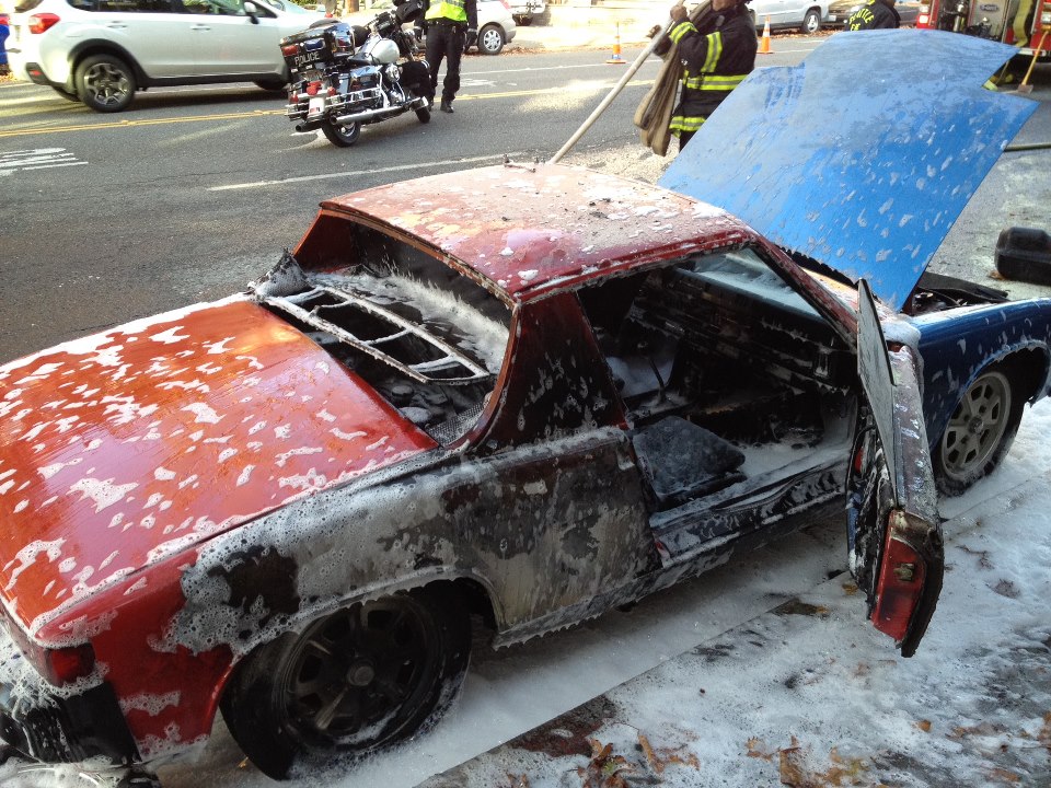

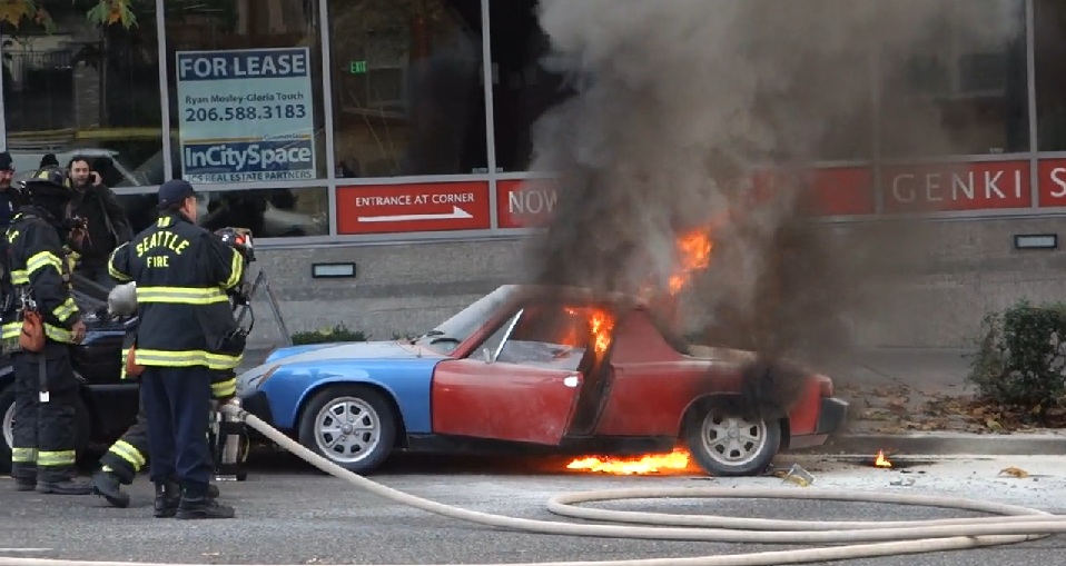

tumamilhem   Not a good use of a 914 fire, but certainly more p...   Dec 12 2012, 01:10 PM
tumamilhem   Maybe he could part out the rest. Look like it...   Dec 12 2012, 01:11 PM
