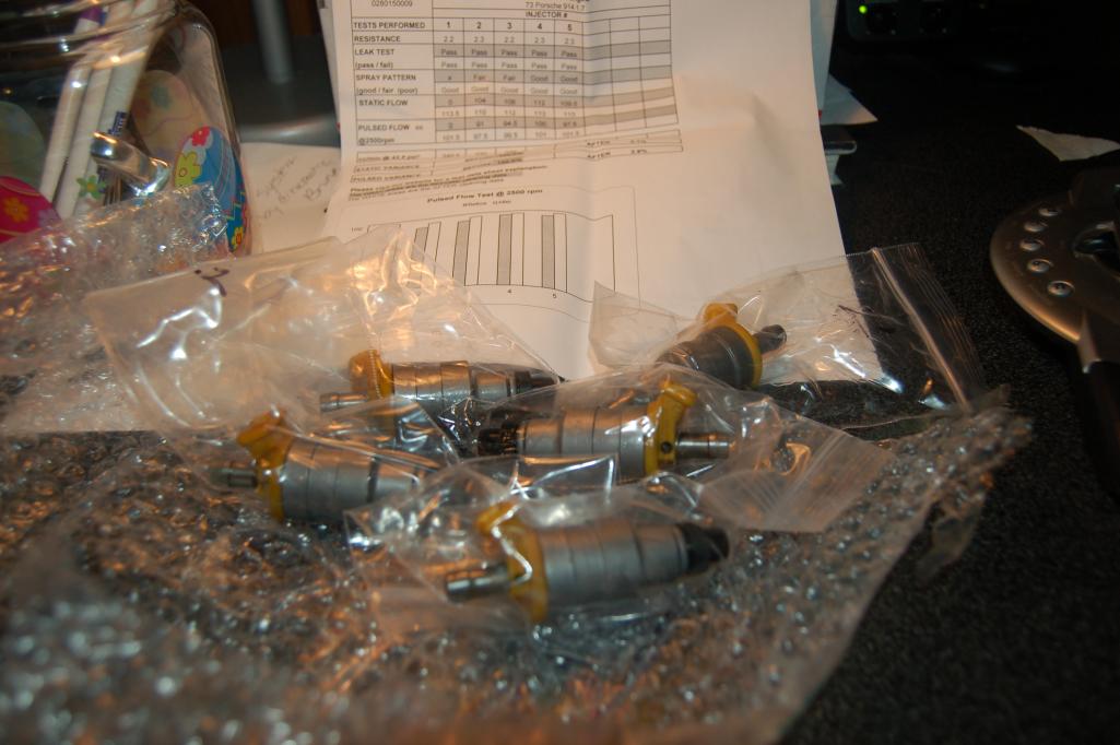

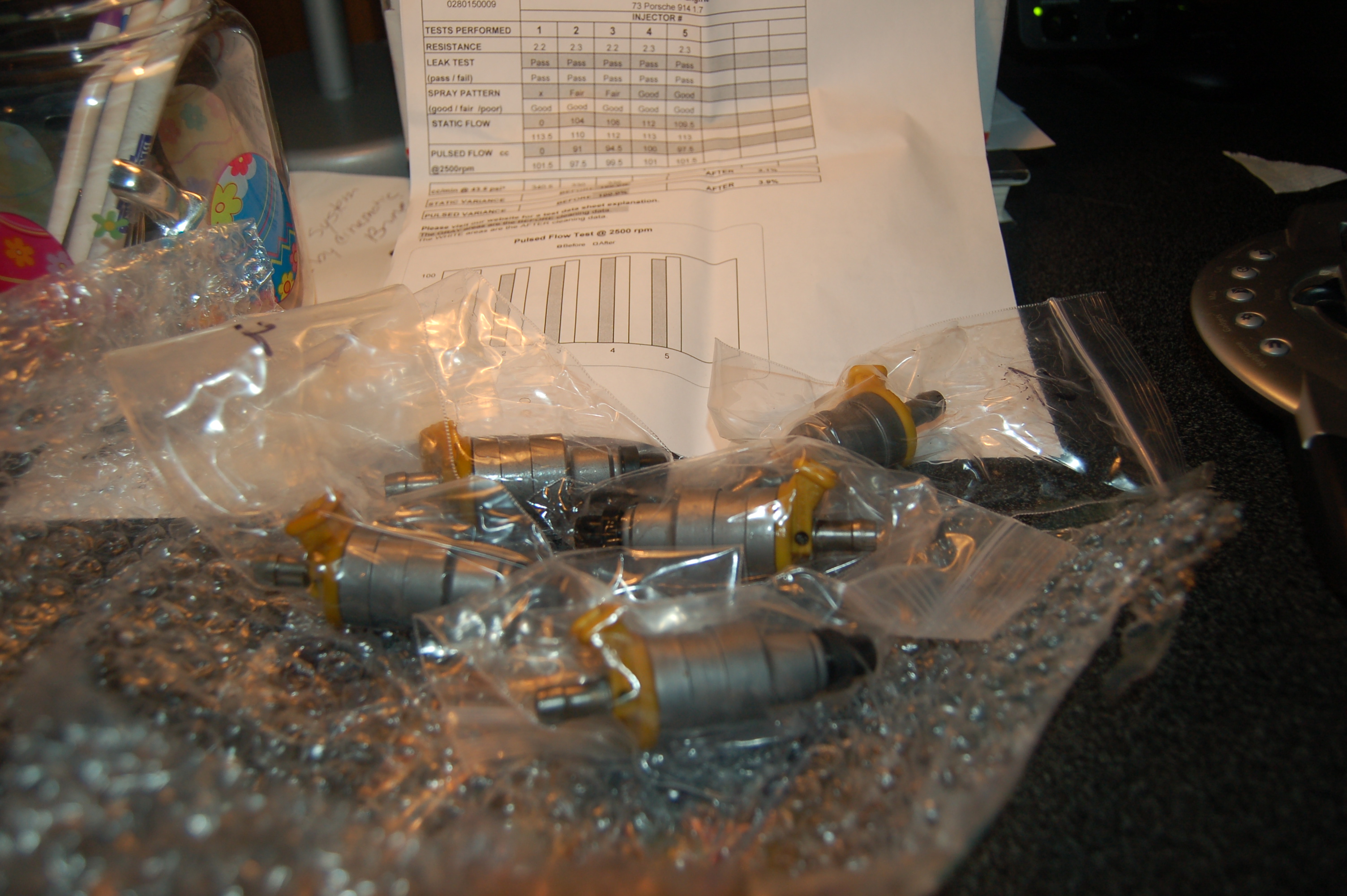

I DROVE MY CAR TONIGHT!!!!!!!!!! I got my injectors back from Witchhunter 2 days ago and got them installed today. I had to bleed the brakes and do a few other odds and ends then the time finally came. For the first time in over 2 years I legally drove on public streets. I definitely still have alot to do but it's almost done for now. I don't have any pics to post other than my injectors and sooner or later I'm gonna post some video but I gotta figure that one out first.
