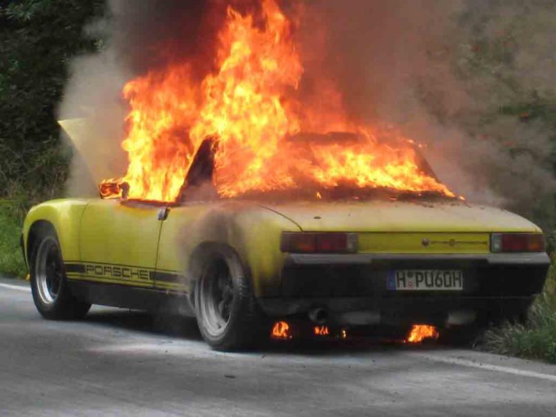

Some fires look like there's nothing that will put it out.... (IMG:style_emoticons/default/sad.gif)
(IMG:http://www.914world.com/bbs2/uploads/post-643-1286303790.jpg)

jim_hoyland   Some fires look like there's nothing that will...   Dec 9 2012, 08:48 AM
tumamilhem   Damn. That's heartbreaking.   Dec 9 2012, 10:17 AM
