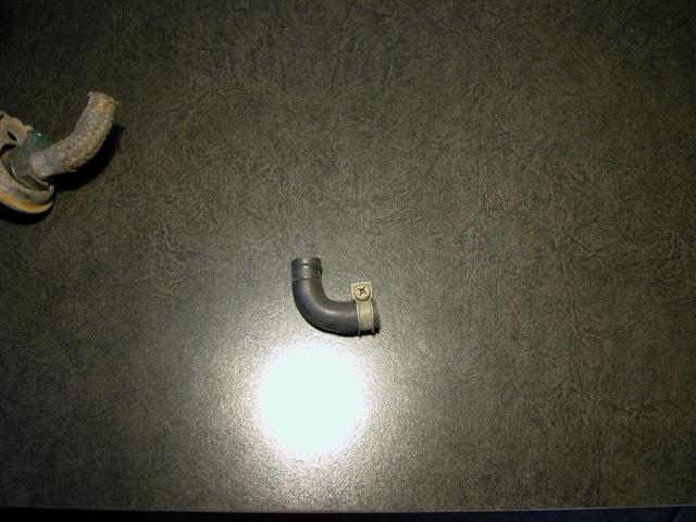

Here is the one supplied in the factory recall to fix the flaming 914 problem.
Note that unlike regualr hose clamps that have flat sharp edges, these have rolled edges.
Seems that the combo of clamping the the old style sharp edged hose clamps into place embedded the sharp edges into the fuel hose, and as the factory fuel hoses expanded from pressure and time, the old style sharp edges cut the fuel hose resulting in fuel sprays and fire.
Here is a link to another thread.HOSE CLAMP LINKY
