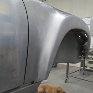

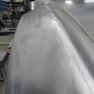

RH side continued.
metal finishing ,stage finished with a bench file
(IMG:http://www.914world.com/bbs2/uploads_offsite/www.themetalsurgeon.com-14902-1355117717.1.jpg)
(IMG:http://www.914world.com/bbs2/uploads_offsite/www.themetalsurgeon.com-14902-1355117717.2.jpg)
(IMG:http://www.914world.com/bbs2/uploads_offsite/www.themetalsurgeon.com-14902-1355117717.3.jpg)
to completion

westtexass2k   Amazing work. What are you using to file down the...   Sep 23 2012, 04:19 PM
The Metal Surgeon   Amazing work. What are you using to file down th...   Oct 21 2012, 10:55 PM

The Metal Surgeon   continuation of grafting.... Front LH fender to g...   Dec 2 2012, 02:07 PM
The Metal Surgeon   Front RH fender/arch removal http://www.914world...   Dec 2 2012, 04:45 PM

The Metal Surgeon   RH side continued. metal finishing ,stage fin...   Dec 9 2012, 11:35 PM
