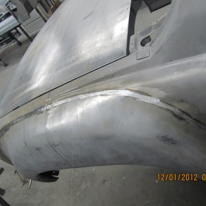

Rear right under way.
(IMG:http://www.914world.com/bbs2/uploads_offsite/www.themetalsurgeon.com-14902-1355117978.1.jpg)

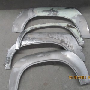

original arches in pretty good shape.
(IMG:http://www.914world.com/bbs2/uploads_offsite/www.themetalsurgeon.com-14902-1355117978.2.jpg)
total time for all the metal work in the project so far 133.5 hrs
