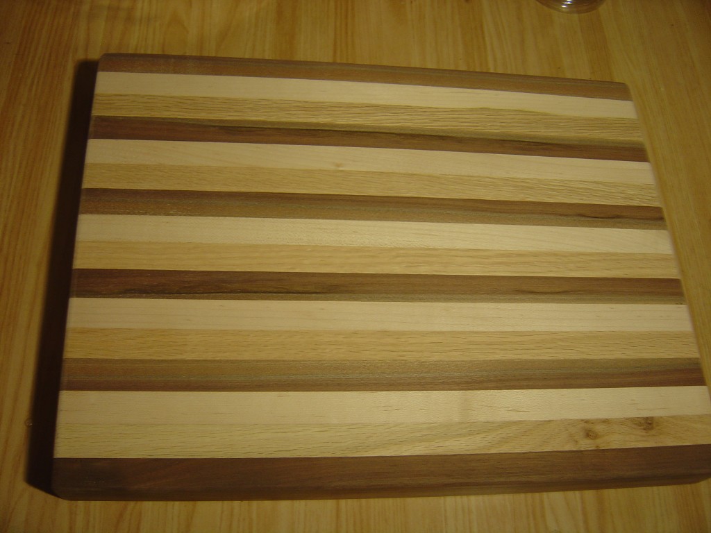

If you want to do a little elbow work, go to a local cabinet maker, get his scraps. Usually they are glad to get rid of them. Using a taable saw or planer, smooth down both edges ( most of the time they are goos to go ) and glue up. Finsh cut and top coat. That's all this butcher block I'm giving my parents for Christmas is (IMG:style_emoticons/default/smile.gif) Freebies and elbow grease (IMG:style_emoticons/default/biggrin.gif) Offset each strip by 50% and you can make as large a top as you want (IMG:style_emoticons/default/beerchug.gif)
