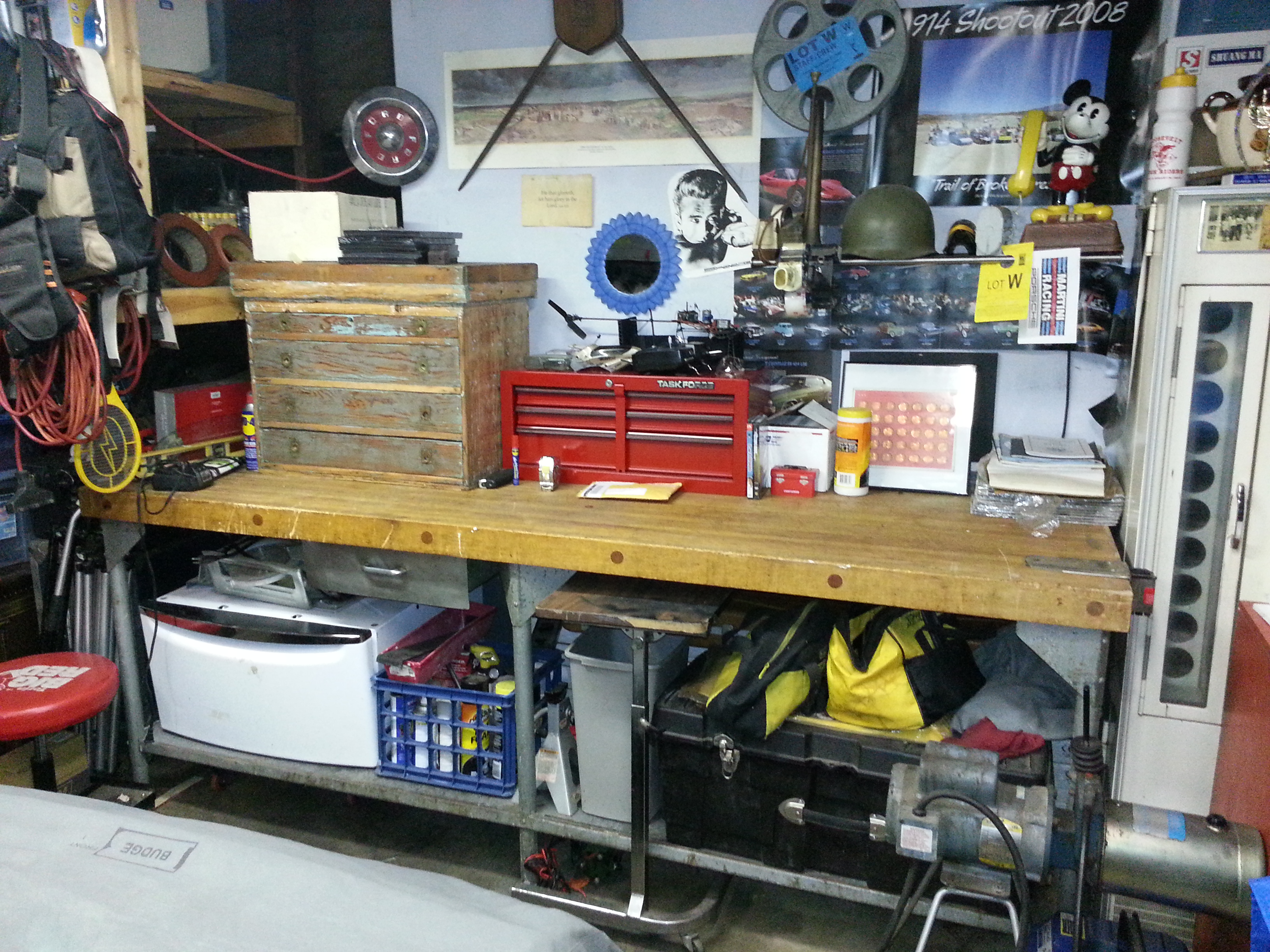

I have this one from Sears.
8 Ft Butcher Block Benchtop

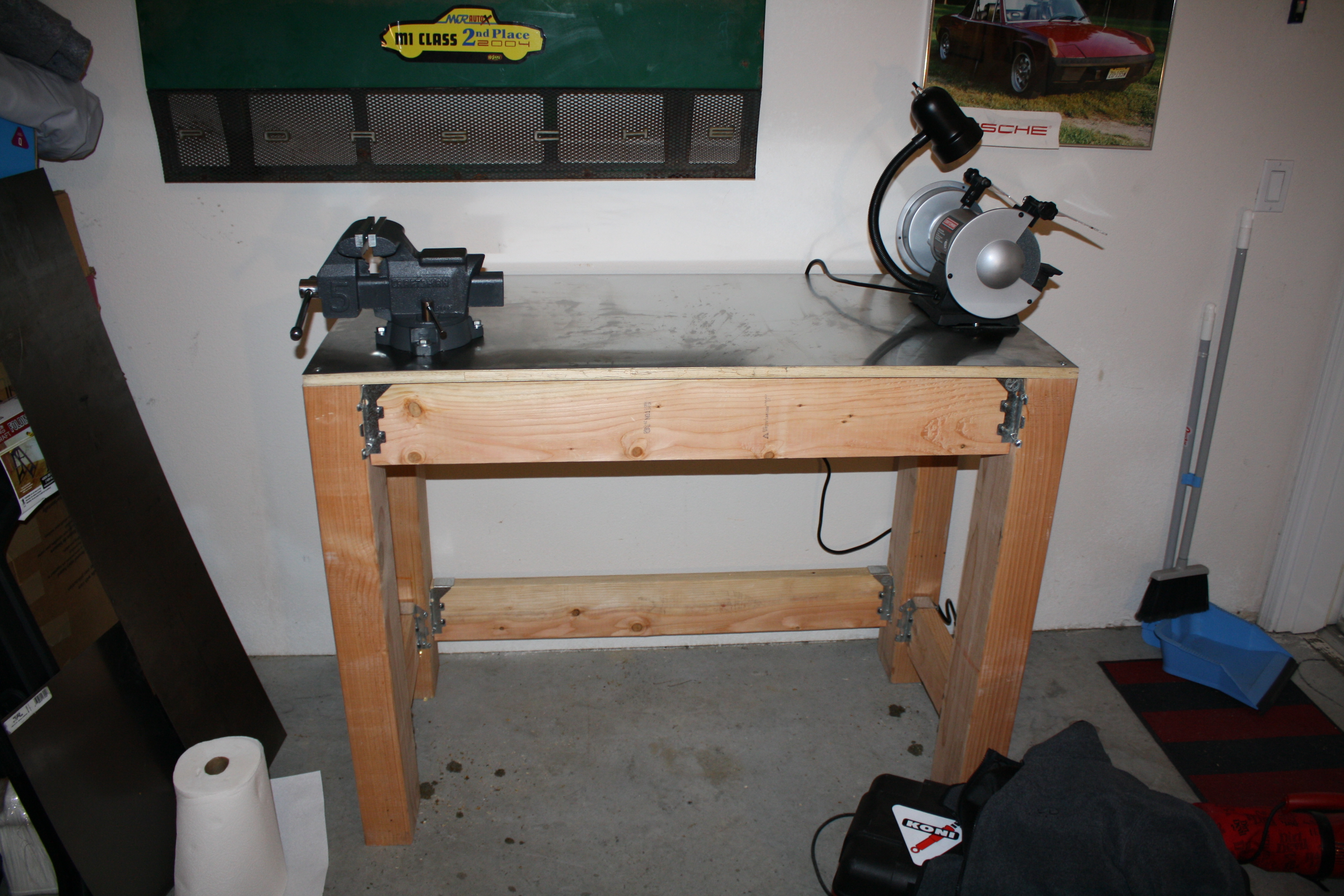

I did mine with 3/4 plywood and covered in in 20G steel (liquid nails to the wood) and wrapped the metal over the edges of the wood. I didn't do stainless, its a dry climate here and really dont have problems with rusting or whatever. Just take a scotchbrite wheel to it annually and it cleans up nice.

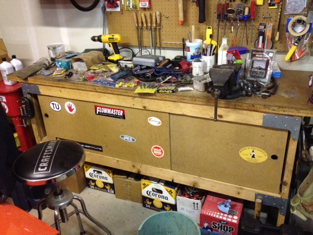

Here is a pic of my work area. Not as large as I would like, but is has been very useful. Two drawer sections with storage 0n the bottom and two tall storage sections on either side.Top is covered with with a 3/4 inch plywood top, and covered with floor tiles (one foot square with adhesive backing).
The back wall is peg board, with a shelf over it. Probably $200.00 to $250.00 invested.
The larger double door storage is for the canned goods.
Tom
Edit: What a cluttered mess! I gotta clean that area up!

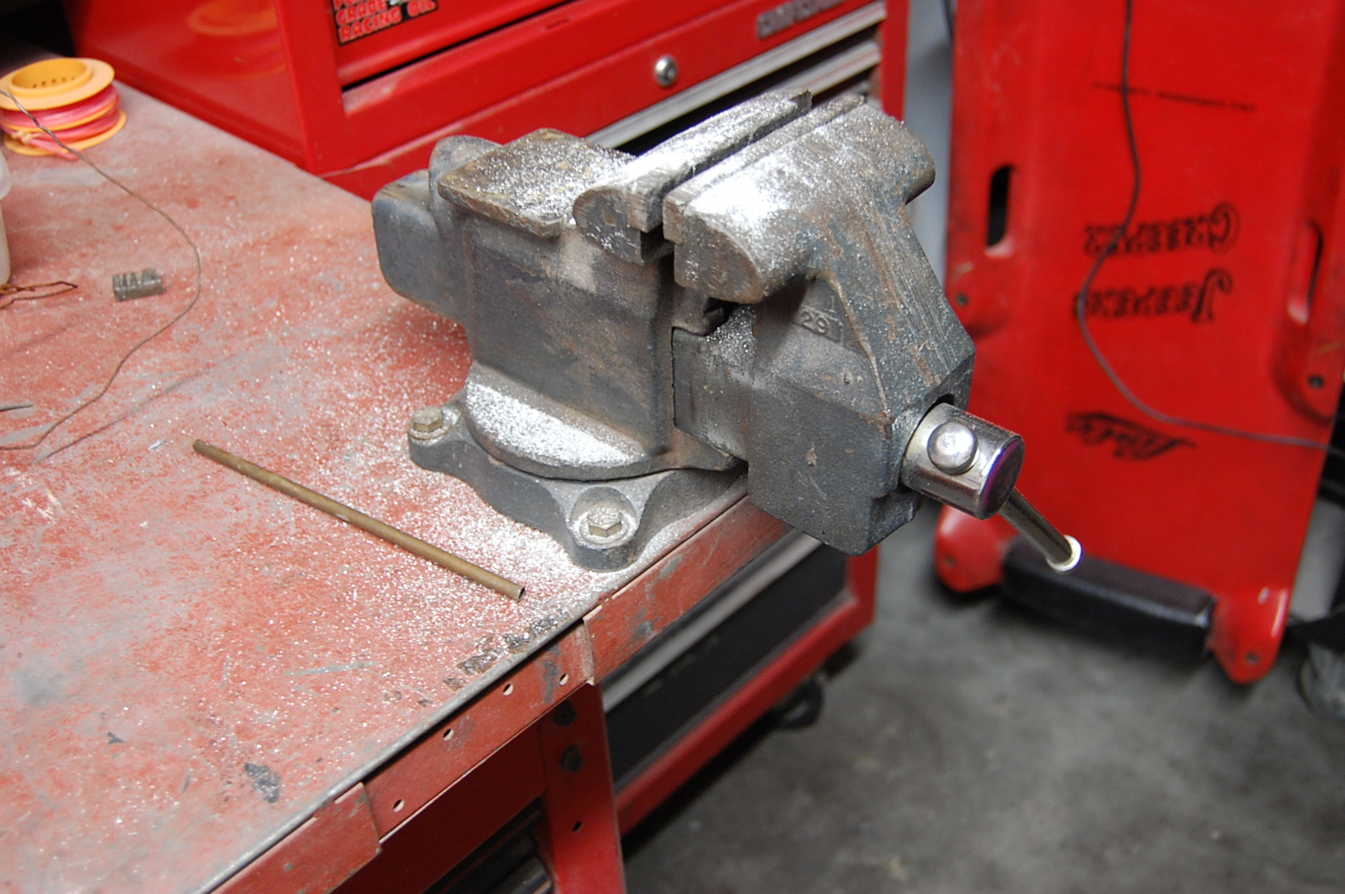

Here is a shot off my vise mounted on my hollow metal door....

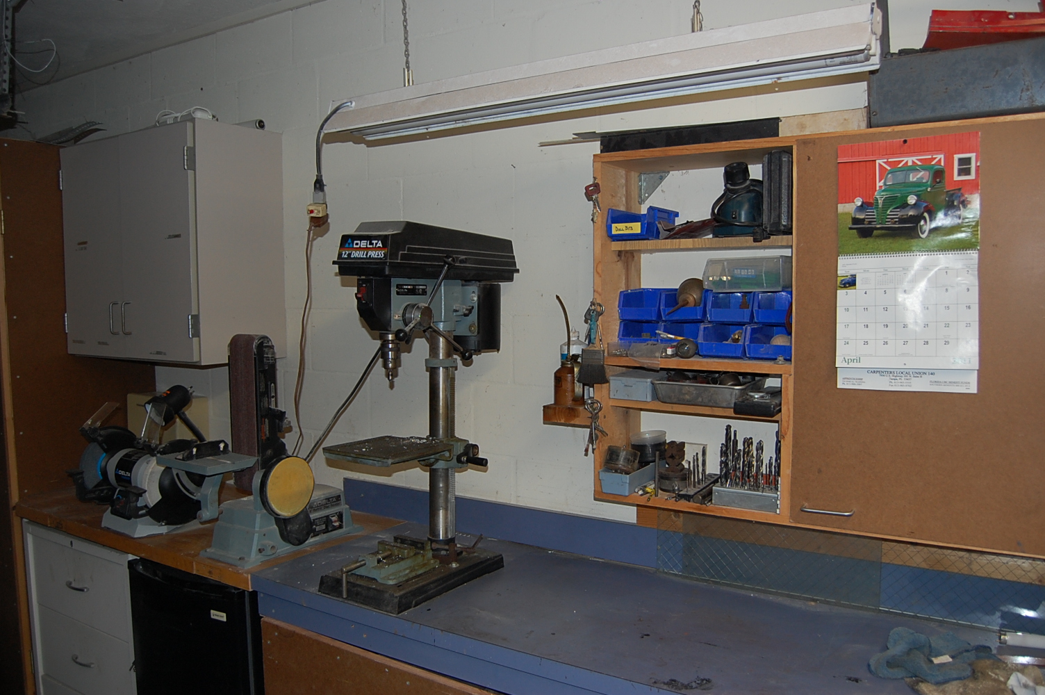

Drill press is on a peice of plastic laminate counter top.....

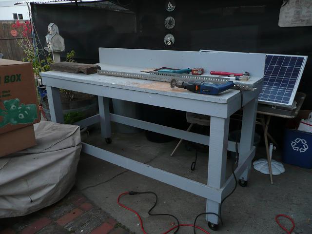

This is a freebie I picked up from one of Joe Sharp's neighbors earlier this year
Click to view attachment4x4 legs, 1x4 rails and 1" particle board top. I added a shelf on top of the lower rails and wheels to move it about. I may cover the top with a sheet of galvanized steel at some point
This is a second work bench ... my garage is so cluttered, I can't even get to the work bench in there
The price was right

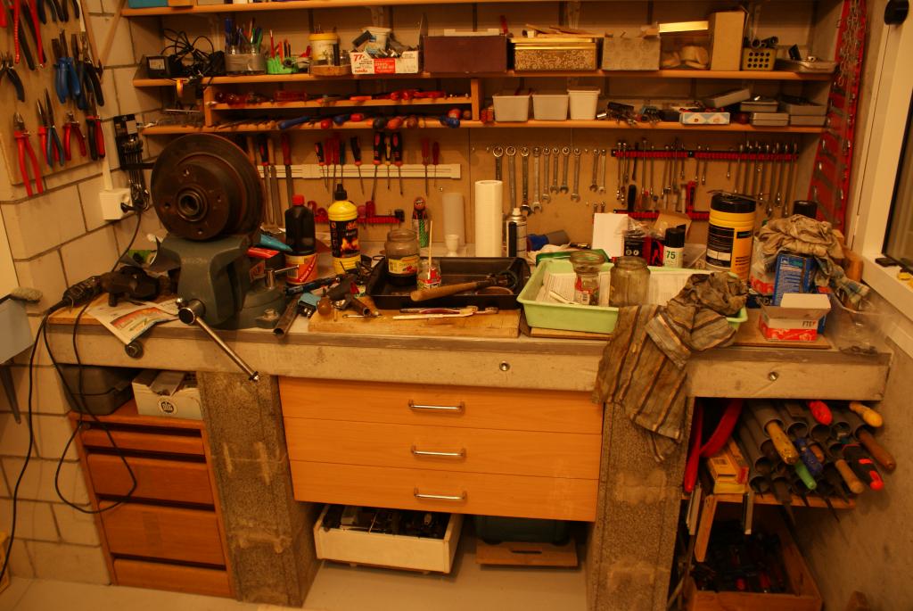

I covered mine with cheap laminate flooring from home depot over top of 2x6's. Good and sturdy, easy to fix.
dian
Dec 21 2012, 10:17 AM
i did exactly the same.

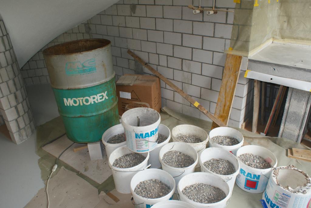

besides i poured this one (in the background):

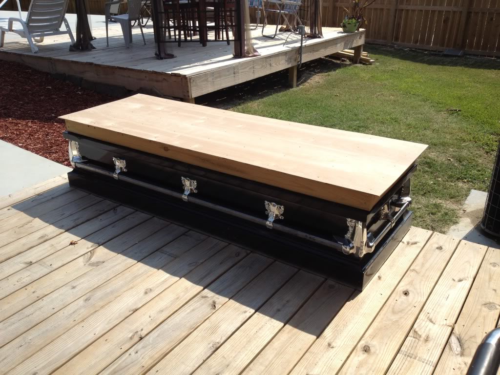

I am with scotty on the freebies. I found some great parts just left behind in an old churchyard. I built a great work bench last summer with it. It's going to be great because you can just flip the top up and store all kinds of stuff in it, once I figure out how to get it unsealed that is. I also need to add a lower frame to bring the height up.

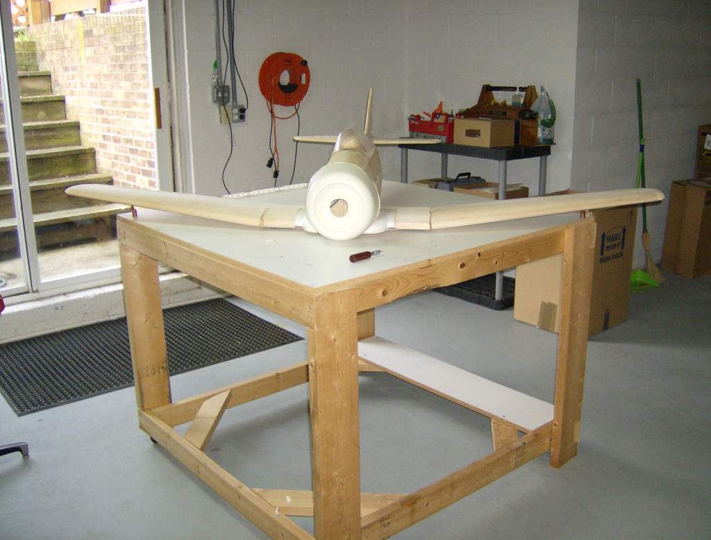

Here's a PORTABLE HEAVY TABLE WORK BENCH 4' X 4' that I made out of 2x4's, 2x6's and white pre cut Laminate Partical boards 2ft x 4ft. The legs on one side only are cut shorter then the legs on the other side so that caster wheels can level and support the table. By lifting the opposite side it can be rolled around to any where you are working at. Also made several 2ft x8ft wall mounted benches using the white Laminated particle boards. They pretty tuff and reflect light plus easy to clean and not that expensive.

Ha ha ha ha, good one. Let's see, where are you from again? Good, now I know never to go anywhere near there.

Yes!See, Dave - I told you that would work.
