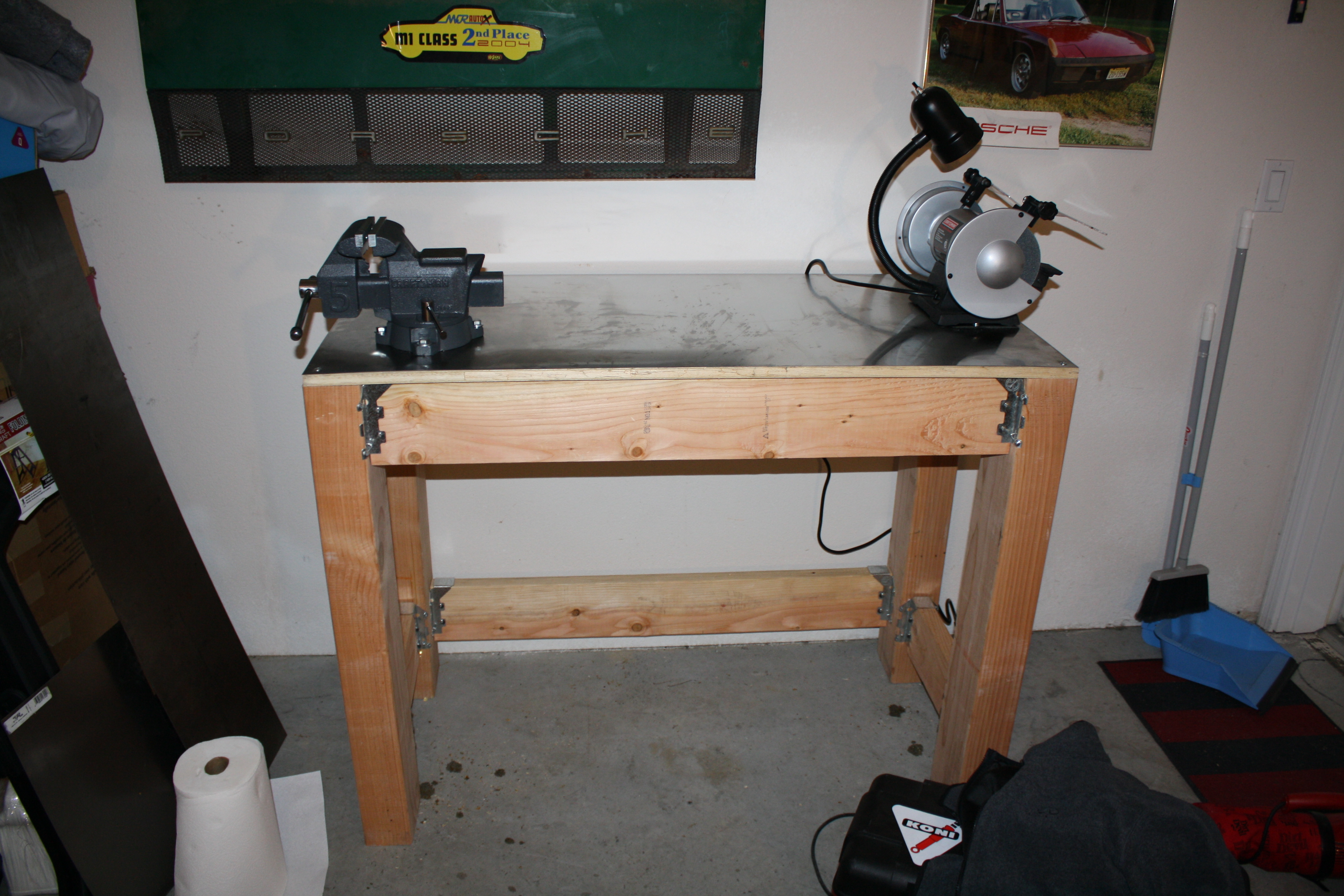

I used a sheet of stainless over MDF. Don't remember the gauge. It's held down with four screws. It looks great when it's clean, and it has served me well in a couple years of moderate use.

I laminated two 3/4 inch sheets of plywood. Routered a groove for a piece of angle iron to protect the edge of the bench. Attached to the studs in the wall and two 2X2 inch tubular steel legs. It's usually a lot more cluttered than it is now. (IMG:style_emoticons/default/laugh.gif)
