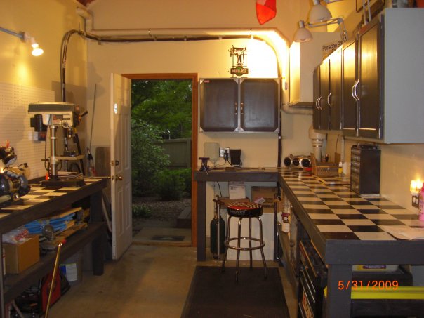

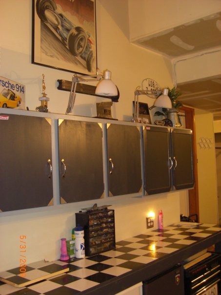

dian   i did exactly the same. besides i poured this one...   Dec 21 2012, 10:17 AM
