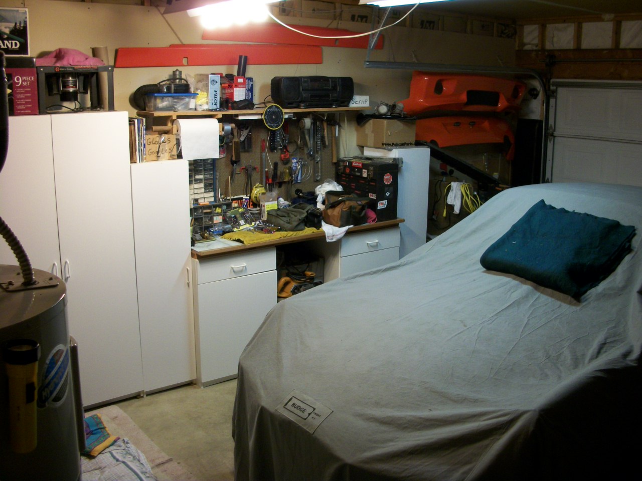

post Dec 20 2012, 07:19 PM
Posts: 2,139
Joined: 21-August 05
From: Port Orchard, WA 98367
Member No.: 4,626
Here is a pic of my work area. Not as large as I would like, but is has been very useful. Two drawer sections with storage 0n the bottom and two tall storage sections on either side.Top is covered with with a 3/4 inch plywood top, and covered with floor tiles (one foot square with adhesive backing).
The back wall is peg board, with a shelf over it. Probably $200.00 to $250.00 invested.
The larger double door storage is for the canned goods.
Tom
Edit: What a cluttered mess! I gotta clean that area up!
