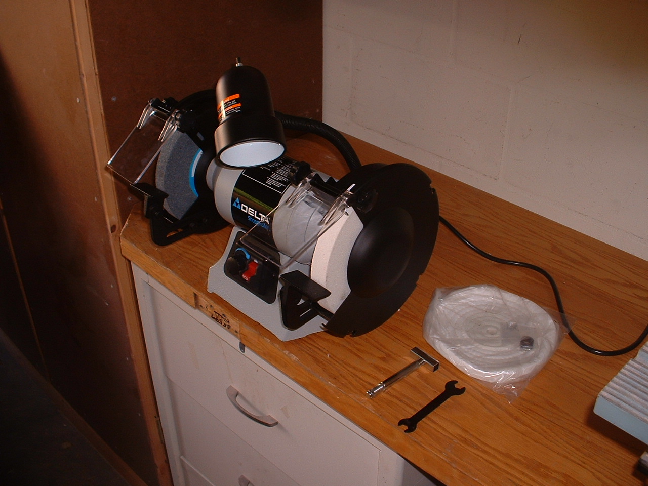

URY914   And my grinder mounted my solid core door OAK .......   Dec 20 2012, 07:26 PM
